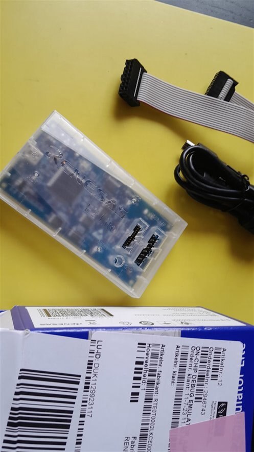

    I bought a debugger to try and find out why my GCC port isn't working.
    I still haven't been able to get the ported firmware to talk to the PC Tool. But I know what works and doesn't work now. All the sampling and the analogue work. The code samples thermocouple, RDT and calculates the temperature.
    What I can't get to work is the serial communication. I may have checked all settings 20 times, and verified the user code extensions. Even checked all config files line by line. But the PC Tool does not want to connect to the board when my firmware is loaded.
