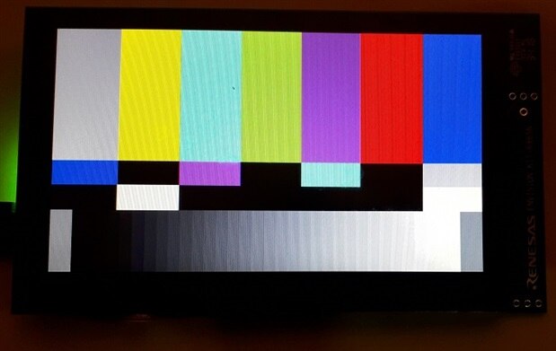

I'm evaluating the Renesas RX65N MCU EV Kit.
In this post,  I'll port the LCD driver example from the Renesas proprietary CC-RX
Renesas offers a GCC toolchain that can build firware for the RX65 family. I have been using it for most of my developments and it works .
The toolchain is nicely integrated in the e2 Studio IDE. The full cycle from project creation to debug is supported.
Let's see how you can port a project from CC-RX to GCC: the QE for Display [RX] Sample Program.
First, create a GCC project in e2 studio. Look at post 2a for  instructions.
Then, use the configurator to add the r_glcdc_rc component.
Enable LCD_CLK Pin and LCD_TCO0 -> 15.
Save and generate code.
Then copy the example sources from the Renesas project over from src to src:
main.c
r_image_config_RX65N_Envision.h
r_lcd_timing_RX65N_Envision.h
Also copy over the image folder. It contains the test pattern.image shown at the beginning of this post.
When you build the cde, it will fail for one source line:
#define FRAME_BUF_BASE_ADDR  (__sectop("FRAME_BUFFER"))
This is because __sectop() is a Renesas toolchain specific construct. It returns the address of the begin of the FRAME BUFFER section.
An other option is to read the documentation. It says that this address = 0x0800000.
That means I can get away by replacing the line with:
#define FRAME_BUF_BASE_ADDR   0x00800000
No other changes are needed. Build and debug.
Once this line in the main() function has been executed, we can manipulate the screen:
    /* ---- Initialization of frame buffer area ---- */
    frame_buffer_initialize();
    /* ---- Initialization of the GLCDC, and start display ---- */
    glcdc_initialize();

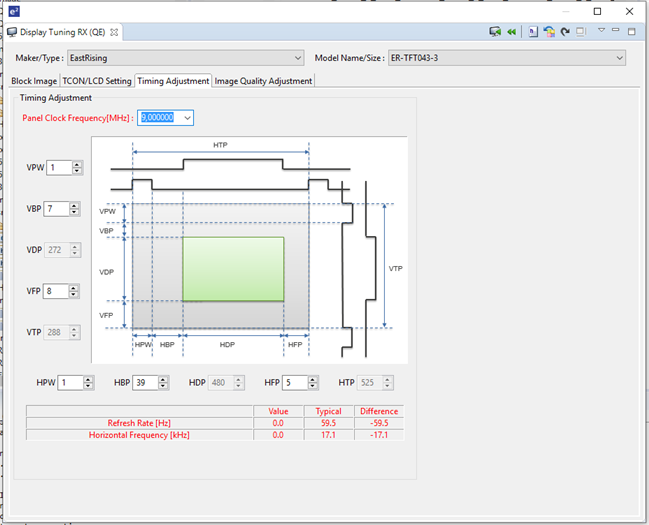

    I'm trying a few new things with this kit.
    Here, I'm using a different display: EastRising 5" 480 * 272. It's the same resolution as the original (an Newhaven), but larger. It doesn't have a capacitive touch screen. I ordered one that (hopefully) matches.
    Some sites mention that it has resistive touch, but I don't know how to enable that on RX65N.
