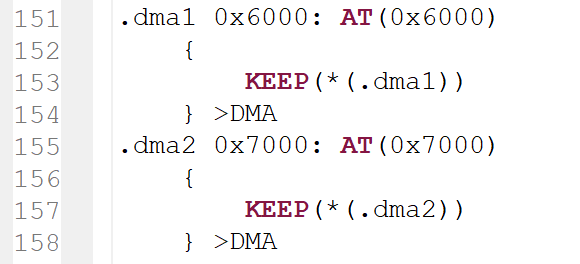

The e² studio project for Road test: Renesas Solution Starter Kit for RX23E-A is built for Renesas CCRX toolchain. I'm porting it to GCC. I've done this before for several RX65 projects (see Renesas RX65 Envision Kit - part 3: Port an example from Renesas toolchain to GCC ). This design is now fully working. e²studio project is attached to the end of the article.
Most of this post is easy. Fair warning:
One section at the end involves direct memory access (DMA), and giving memory buffers a fixed, aligned  address. This is an advanced topic. You 'll only have to touch this when you use DMA functionality. I tried to explain it in an understandable way. Comment if it's not clear. I provide the e² studio project with sources, linker scripts and binaries as attachment.

Day 3: add and configure SCI and DMA FIT modules
One of the more complex activities: port the serial port and the DMA mechanism.
Add the serial communication module from the Board tap, then click on the Link button.
It 'll navigate to the SCI1 component.
Configure it:
We'll copy over some additional code for it on day 4.
From the SCI component, add 2 DMA Controllers, for RX and TX
Configure DMA0
Configure DMA3

Day 8: DMA buffers, and glue all together in main()
We'll have to revisit the GCC linker script and memory lay-out.
The DMA section below isn't obvious. It took me a week to find out why the GCC version did not want to connect to Renesas' PC Tool. Turned out that it's related to the memory alignment of DMA the buffers.
Adapt the loaders / linker script for DMA buffer alignment
To make DMA FIT modules work, buffer memory has to be at aligned memory spaces. I haven't found the correct allignment yet, but the Renesas toolchain puts these buffers at locations that are 0x1000 aligned. I adapted the GCC linker script to reflect a similar situation. I created 2 fixed position sections, both placed in the RAM memory region.
MEMORY
	RAM : ORIGIN = 0x4, LENGTH = 0x7ffc
	ROM : ORIGIN = 0xFFFC0000, LENGTH = 262144
	OFS : ORIGIN = 0xFFFFFF80, LENGTH = 16
SECTIONS
.dma1 0x6000 (NOLOAD) : AT(0x6000)
		KEEP(*(.dma1))
	} >RAM
.dma2 0x7000 (NOLOAD) : AT(0x7000)
		KEEP(*(.dma2))
	} >RAM
The buffers are 4 KB (write) and 0.5 KB (read). I placed each in a section starting at a 0x1000 address. The NOLOAD attribute takes care that the Loader / Flash Programmer doesn't try to write to these addresses while programming the device.
Adapt the main file to take care that the buffers are allocated to the DMA memory
I tried to avoid changing Renesas' code as much as possible. This is the only occurrence where I can't do that. Assigning variables to memory sections isn't the same in the CC-RX and GCC toolchains. Luckily, there's a set of defines that 'll help us. __CCRX__ is only defined when the project is configured for CC-RX. __GNUC__ is defined when the GCC toolchain is selected. Let's exploit that in the code to use the toolchain specific methods to place the variables at a good location. The code within the __CCRX__ area is the original code you get when downloading Renesas' example project. The code in the __GNUC__ is my port.
#if defined(__CCRX__)
#pragma section B B_DMAC_REPEAT_AREA                    /** Address alignment for DMAC repeat area          */
    static uint8_t s_send_ary[D_PRV_SEND_ARY_LEN];      /** DMAC3 transfer source                           */
    static uint8_t s_recv_ary[D_PRV_RECV_ARY_LEN];      /** DMAC0 transfer destination                      */
#pragma section
#endif
#if defined(__GNUC__)
    static uint8_t s_send_ary[D_PRV_SEND_ARY_LEN] __attribute__ ((section (".dma1"))); /** DMAC3 transfer source                           */
    static uint8_t s_recv_ary[D_PRV_RECV_ARY_LEN] __attribute__ ((section (".dma2"))); /** DMAC0 transfer destination                      */
#endif

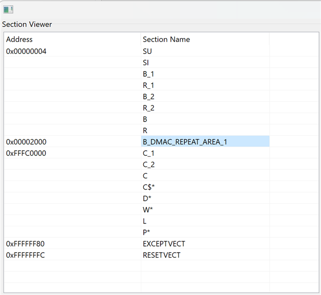

The allocation is correct. Here's a view of Renesas' memory use view:
.dma1 is at address 0x6000 and contains the 4 KB buffer.
.dma2 is at address 0x7000, contains the 512 bytes buffer.
I know it doesn't look spectacular, but it took me a week to find out that this was the cause for the PC Tool application giving a "Failed to Connect" error.

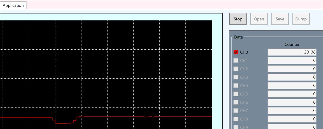

    Jan Cumps over 3 years ago in reply to Jan Cumps
    20.000 samples tested. I call it stable
    I had to finetune the approach above, because I got into memoryt errors after approx. 400 samples. I have now placed both read and write buffer at a guaranteed 0x?000 boundary, and it runs like a clock
    I have a 3K continuous area left in that memory block that could be recovered and used for something else ...

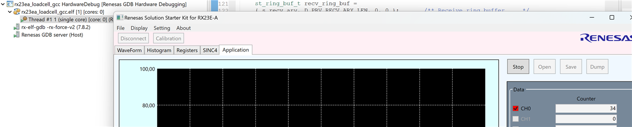

    That was it! DMA buffer alignment. Here's the Load Cell firmware, compiled with GCC, running on the PC Tool:
    I'll update the blog, because the work to do this isn't straightforward.
    Summary: create a memory region in the linker file (I stole it from the RAM block):
    MEMORY
    RAM : ORIGIN = 0x4, LENGTH = 0x2ffc
    DMA : ORIGIN = 0x3000, LENGTH = 0x2000
    Create a section that uses this block, with alignment (I don't know yet what alignment is needed:
    .dma ALIGN(0x2000) (NOLOAD) :
    KEEP(*(.dma))
    } >DMA
    Then use GCC specific directives to place the buffers in that section. I used #defines to check if the source is compiled under GCC or RXCC. I have to use it, because this variable placement in a particular section is toolchain specific.
    #pragma section
    #endif
    static uint8_t s_send_ary[D_PRV_SEND_ARY_LEN] __attribute__ ((section (".dma"))); /** DMAC3 transfer source */
    static uint8_t s_recv_ary[D_PRV_RECV_ARY_LEN] __attribute__ ((section (".dma"))); /** DMAC0 transfer destination */
    #endif
    It works now :)

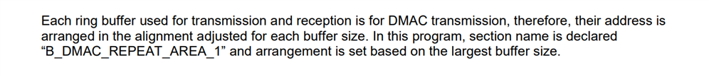

    My current suspicion is that it's related to DMA memory
    #pragma section
    #endif

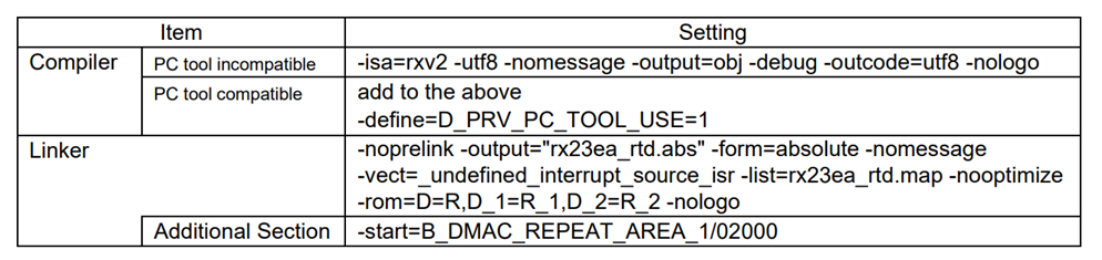

    If I look at the manual:
    And in the CCRX Toolchain settings:
    Let's check if I can replicate such a section and parameter placement in GCC. I've done similar for an RX65N ...

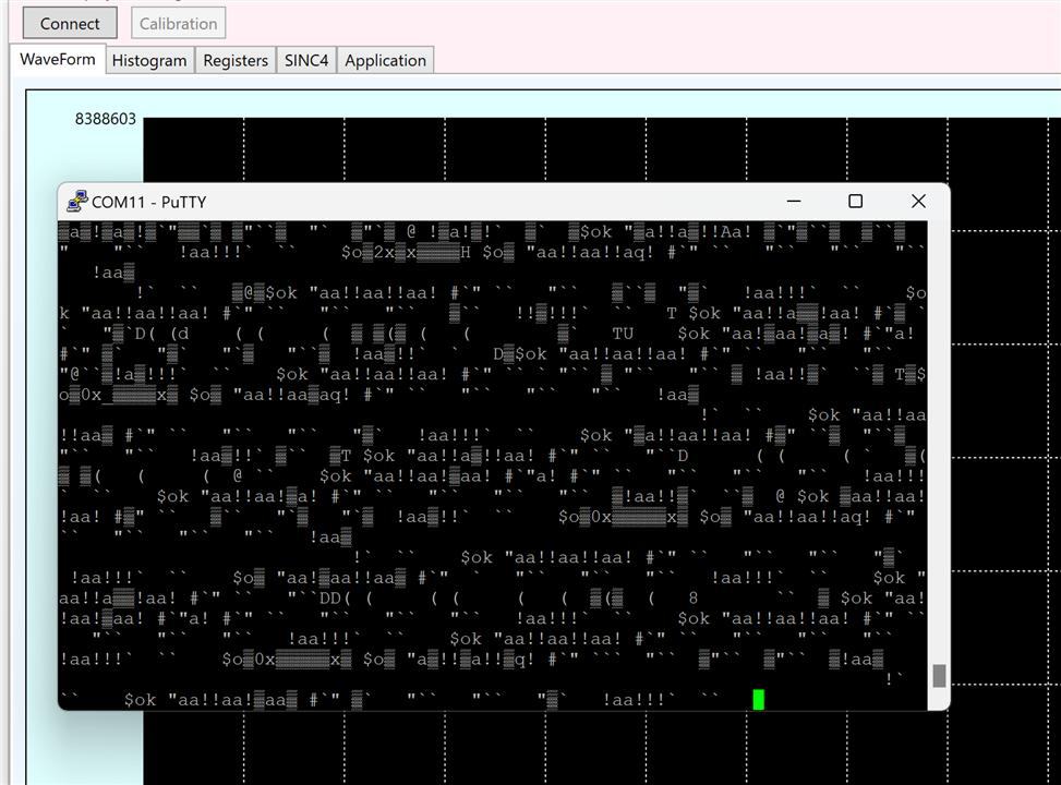

    I tried to port the Load Cell step by step, and I get the same problem. The PC Tool app does not want to connect.
    The serial port is working - I have connected Putty with the same settings and the port is spawning readings ...
