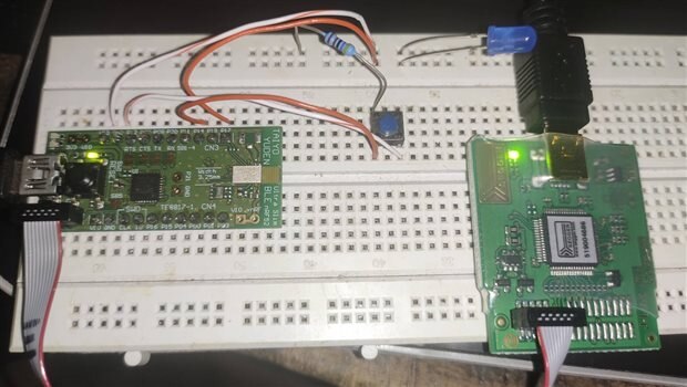

To control the LED over BLE, access to the processor core layer and soft device must be implemented (used Soft Device 12). First, I connected debugger to BLE module with SWD cable. Then on, USB  interphase to the computer running Segger Embedded IDE. With connections being planned, I interphased LED to GPIO 17 and Pushbutton to GPIO 14 which is pulled up with 4K7 resistor.

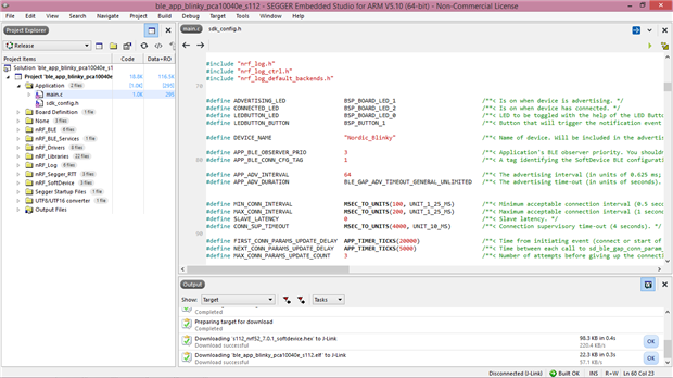

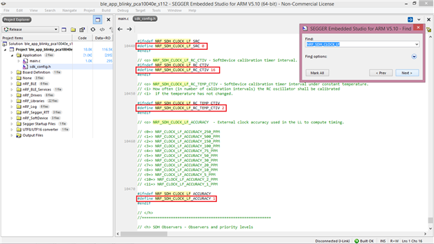

This being opened, there are some modifications to be done in order to support Taiyo Yuden EYSNSNZWW. Go to "sdk_config.h" in the left file-navigation window and change the clock configuration. By default, the firmware is configured to 32kHz external crystal oscillator(XTAL) which is not actually present in this module. Following is the updated image with clock values set as per.

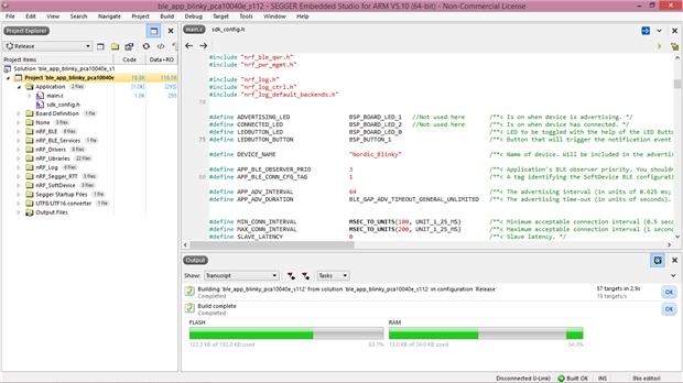

Next step is to configure the LED and Switch pins which again, come by default as per Nordic BLE development Kit. If respective modifications are done as shown in the below image, it's done program is ready to build.
But why?
There is a small anomaly in pin definitions of nRF BLE and Taiyo Yuden BLE. In firmware, LED Pin declaration number starts from LED1, LED2, LED3 and Button1, Button2,......etc which is as LED0, LED1, LED2 and Button0, Button1,...etc for Taiyo Yuden modules. This is a major point to be noted because of which you can save a few hours in figuring out stuff( I spent an hour though image )

All these being done, its time to build.
Built? Upload and its done. The module must start streaming BLE and accessing the nRF Toolkit app, the connection can be established through which wireless control works!
