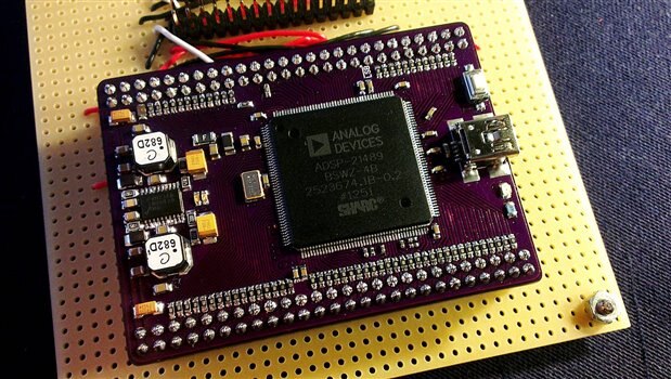

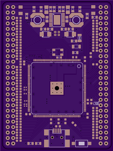

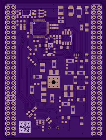

Hello, does any one are interested in Analog devices Shark development kit ?
Basically it is ADSP-21489 floating point DSP running at 450MHz ( possible to 700MHz overclock) with all pins connected to header (except single UART for debugging and boot pins for spi flash since i am using dual channel FT2232 for debugging/programing)
I made Labview program that can program external SPI flash with FT2232D  from Labview by using loader file generated inside  Crosscore or VisualDSP++ IDE. This can be very high performance calculation engine for demanding applications. I can do single point DFT with 128 array at 2MHz repetition rate, while ARM Cortex M4 (STM32F407 running 250MHz can only do 50KHz !! )
Here is what Shark DSP can do in native calculation image (Mandelbrot fractal in f32 )
At the moment i have single unpopulated board , but can order more if demand is big. With additional cost i can buy all parts, assemble and ship it as full development kit.

    Since i don't have jtag for analog products (USB_ICE) and it cost more than i can spend , programming is done by using FTDI FT2232D SPI interface.
    Idea is simple: hold DSP in reset, so all pins are in high-z state, enable bus drivers connected to FT2232D SPI output ( same pin as hold DSP in reset), delete flash ( as many pages as needed for ldr file) and when all data is inside flash, disable bus drivers to high-z state and release DSP from reset.
    Only problem i am facing right now is that i need to hold reset button while i programming DSP, even when i probe it, FT2232 does hold DSP in reset without any problems. Small problem, i guess i need to add some delay inside programming loop for bus drivers since if i enable them with reset button and when release, flash is programmed correctly
