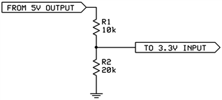

Can someone explain how to interface the rfid module with the freedom board kl-25z.

    gadget.iom over 11 years ago
    The 16 pin DIP component looks like a MAX232 chip. If you look at the datasheet for that component you will see a T1 in Connection (possibly pin 11).
    If you pull out the IC and push a prototyping wire into the socket at that pin, you can connect the other end to your MCU. The communication should then take place at TTL level.
    You will also need to level-shift the 5v on the rfid board to 3.3v for your Freescale board.

    e14 Contributor over 11 years ago in reply to gadget.iom
    Thank you for the help. Could you also mention what to use to level shift from 5V to 3.3V?
    mcb1 over 11 years ago in reply to e14 Contributor
    Apart from searching using google, you could use two resistors as a voltage divider.
    It appears from the datasheet that its just Tx from the chip.
    The output from the MAX232 is RS232 levels so you need to ditch that.
