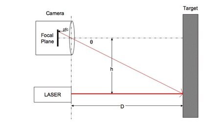

    0 Catwell over 15 years ago in reply to e14 Contributor
    Billpenner & Frost,
    I like the lasr range finder option most. Although I was looking for a simpler answer, I think this may work out well.
    Some thoughts on how to actually build such a device? If it isn't too expensive, I will attempt to build it.
    The theory:
    Distance = h / tan(theta)
    This is what you are proposing?
    Cabe

    0 e14 Contributor over 14 years ago in reply to Catwell
    Your picture is pretty much what I thought, except the laser would need to be set at angle theta, on the "source" block. Movments on the target block away / towards source would then change where the reflected laser point hit the target.
    Either way, you've got a mirror / reflector / angle problem to solve. Setting theta for the laser shouldn't be too hard - simply accurately measure a right angled triangle inside a large room, the triangle is of known proportions, bingo, you've got a known theta.
    The other way is to get a reflector set at angle theta on the target block. A little bit harder, and if it's moving, it may change the angle and destroy accuracy. If you use a flat mirror on the target, it's probably simpler all round.
    Anyway, it looks like the final calc is going to be distance = (h/2) / tan(theta) as your diagram would appear to show the beam reflecting off a surface with a mirror set at theta degrees.
    So, detecting where the laser pointer hits is the last problem to solve. Preferably, I suppose you'd use as few optical components as possible as that way is going to be expensive, due to accuracy depending on quality and ability to set correctly. Simplest option I can think of is to print off a scale on a laser printer / A4 paper, and use this for the beam to hit and for a camera to see. Software can then determine where the beam is hitting, maybe even without a printed scale, and convert to distance.
    In my opinion, using software to do the bulk of the work is going to be the best / cheapest way in terms of physical cost, apart from perhaps time. All you'd need to do though is detect at what point the colour thresholds exceed a certain value, in the X and Y planes. A camera looking at the back of the sheet of paper should do this ok. Classes are available in both .NET and Java to do this, depending on your preference.
    For more accuracy this way, the simplest method is to make angle theta more obtuse, therefore affecting h more over a given distance. To calibrate such a device, measure distance D at two points with calipers, and then mark the spot positions (in software / on paper / however) as required. Determining distance between these two points should be a simple matter of interpolation.
