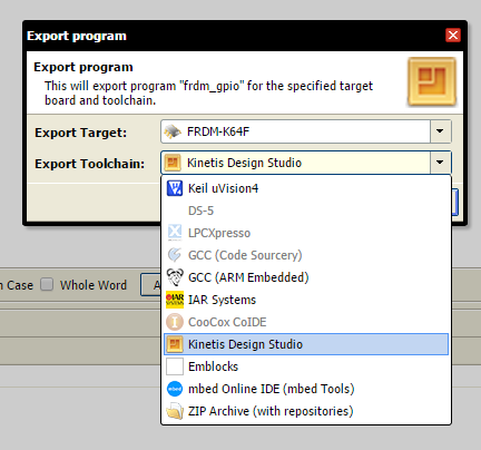

    In mbed, right click on your project and select "Export Program..."
    Then in the dialog box that comes up, select the Kinetis Design Studio toolchain under "Export Toolchain:" and then click on the Export button. You could of course also select the other available toolchains like Keil or IAR.

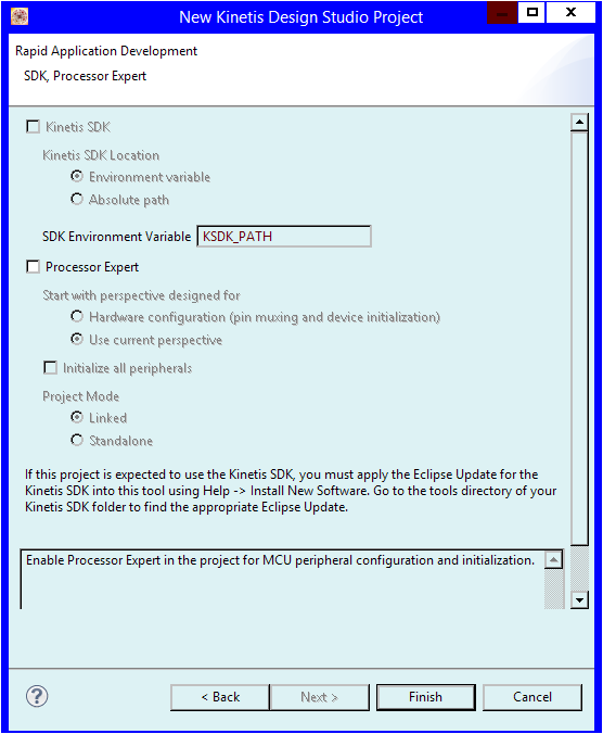

    Hi george,
    You have to install the KSDK eclipse plugin first. That plugin is what tells KDS (and other eclipse based tools) about Kinetis SDK.  Instructions are in Section 4.4.1 of the C:\Freescale\KSDK_1.0.0\doc\Kinetis SDK K64 User's Guide.pdf
      Then when using the new project wizard, you also have to make sure you're selecting a device/board supported by Kinetis SDK.
      You don't have to re-install KSDK. Hope that helps.

    To debug with Kinetis Design Studio, you need to reprogram the OpenSDA debug interface of your FRDM-K64F which is preprogrammed in factory with the mbed mode. Simply keep reset button press while plugging the -mini-USB cable to the USB port corresponding to the OpenSDA interface. In windows file explorer, you will see a new drive Bootloader. Drag n drop the Segger JLink v2.0 file inside then unplug and replug your usb cable. Bootloader drive should have disappeared and you should have a new JLink device in Device Manager. Your board is now setup to debug in KDS.
    As mentioned by Anthony KDS is the compiler/debugger toolchain and KSDK is a library/driver package. To avoid a frequent KDS update as soon as a new Kinetis derivatives are launched, Freescale has developped KSDK separately to the compiler/debugger. To get KSDK available in KDS 2.0, no need to reinstall it, you just need to go to Help/Install New Software make Add, then Archive and select the file "SDK_1.0.0-GA_Update_for_Eclipse.zip" available at KSDK_1.0.0\tools\eclipse_update as explained in the Kinetis SDK User Guide.
