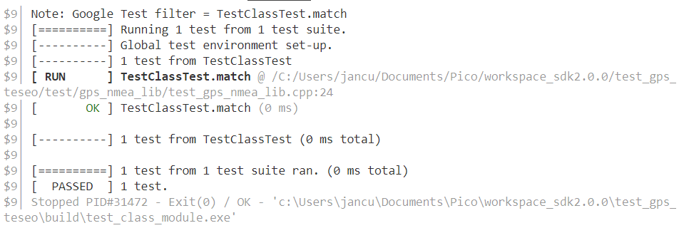

Results of my test run:

GTest will now do 2 things for us:
  • create the object, as before
  • call its set_match_string() and set the string to "match".
The fixture test case does not change:
TEST_F(TestClassTest, match) {
    EXPECT_TRUE(o.match("match")); // should pass
That's it. In part 1 of the post we learn how to automatically create (a set of) objects before a test gets executed.
In part 2, we configure those objects, after they are created.
This is the main story about test fixtures. They allow you to set up an object structure before a test case is run, and configure those objects. Then it executes your tests on them.
