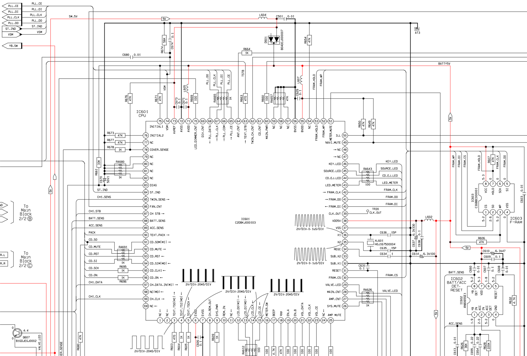

I don't have a schematic, but the ElectroTanya website offered a service manual for the CQ-TX5500, so I looked at that instead. I experimented with the resistors highlighted here:
A bit more of the schematic from that CQ-TX5500 model (click to zoom):
The configuration is likely stored in the FRAM chip visible to the right of the NEC microcontroller chip. I could desolder it and extract the contents, but there's only finite time to try to repair this car stereo, and I didn't do this. Even if I succeeded in changing the band in this manner, it still may not work if the VCO connected to the synthesizer chip needs adjustment/component changes. For now, if the owner wishes to use the FM band in the UK, there is the possibility to purchase a cheap band converter device that connects to the antenna socket (the wrong frequency will be displayed however). It's an ugly solution, but it is a solution.
