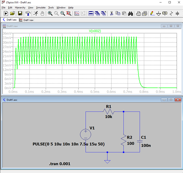

    dougw over 4 years ago +5
    The analogWrite instruction uses PWM and a resistor and capacitor on the pin to generate an analog voltage: https://www.instructables.com/Arduino-RC-Circuit-PWM-to-analog-DC/ The Mega can have 14 PWM pins…

    michaelkellett over 4 years ago in reply to dougw
    The capacitor value may not be ideal.
    The time constant of the RC filter is 10us as drawn.
    With a PWM frequency of 64kHz (about as fast as an Arduino can go) this will make a lot of ripple.
    The ripple is at 64kHz and may not matter. But if it does then increas the value of R1 and R2 by a factor of 10 or more (the limit is the source impedance you can cope with).
    Or increase C1.
    The lmit of the max RC that is tolerable will depoend on the response time you need. With these values it's less than 100us which is probably much too fast.
    With C1 = 10uF the response time will be less than 10ms and the ripple down to 0.3mV pk-pk (about 1.2%).
    MK

    dougw over 4 years ago in reply to michaelkellett
    Good point Michael. I didn't calculate the ripple. While an analog meter is a type of filter, getting the ripple down is as easy as picking a better cap.

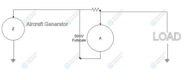

  • phoenixcomm
    phoenixcomm over 4 years ago in reply to geralds
    geralds Hi, basically i need to emulate a high current shunt, my load meter has 50mV fullscale defection.
    there are pics and info about the load meter here.
    grr. could not load my tiff image. so basically you have a generator with - to ground and + to the shunt, on one side of the shunt run a wire to the meter, and another to the LOAD. the other side of the shunt one of the wires goes to the loads ground the other wire goes to the - terminal on the meter.
    I just had a senior moment I converted the image from tiff to jpg. :)
    I want to do this with the PCM output from the Arduino Max. The meter has 16 tics, so I really should hit all of them + the ones in-between as well
    I need to spend as little money as possible, or, as cheaply as I can get away with.
    thanks again.
    ~Cris.
    BTW since the meter is messuring Load which is just a percent of Total load so arbitry numbers are fine.

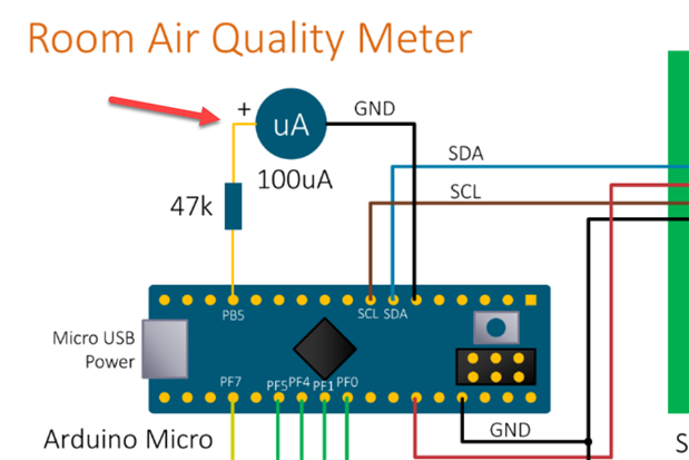

    shabaz over 4 years ago
    Hi Cris,
    I just remembered I had to drive a meter with Arduino too a while back, although I used an Arduino Micro, maybe the ideas are similar with Arduino Mega).
    The info is here:
    Sensirion Gas/Temp/Humidity Sensor Kit - Review
    The code is here:
    https://github.com/shabaz123/FeelWellMeter/blob/master/env-sensor.ino

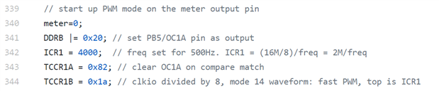

    I don't remember it in any detail, but line 23 in the code there defines the constant 'meter' to be pin PB5, where the meter is wired as can be seen in the diagram above.
    Lines 339-344 set up the PWM mode, and this may change on Arduino Mega.

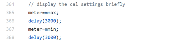

    Then, whenever the meter reading needs to change, then 'meter' is just set to a different value.
    For example, to make the needle swing to maximum, then wait three seconds, then swing to minimum, the following code is used (max and mmin can be calculated or just try any values for experimentally determining them, in my case they were 100 and 3500 respectively, for the 100uA meter):

    phoenixcomm over 4 years ago in reply to shabaz
    shabaz looks very straight forward I shall give it a try. From what I am seeing for my 50mv meter all I will have to do double R1 to about 95 ohms.
