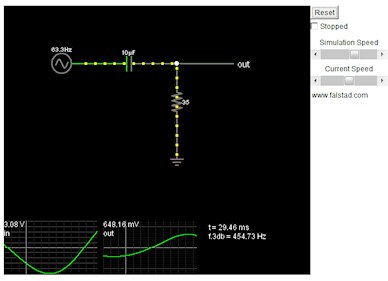

    If you want to experiment, you could try a simulator. Here is a simulation of a filter. You can alter the component values if desired. Notice when you run it, the input signal frequency slowly increases. You can observe the input signal, and the output graphs at the bottom, dynamically.
    EDIT: here is a practical example of building block #2 (filter).
