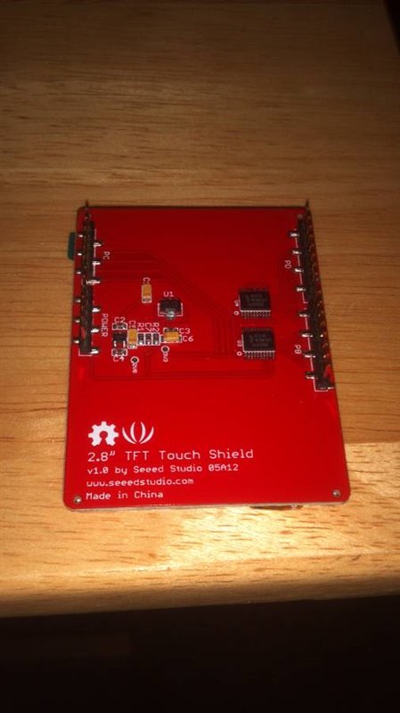

I purchased this screen which I told was compatible with the Raspberry pi (model B) after getting it home I soon realized I was ripped off and the seller was long gone!
this is not the seller but it is the same thing (SEEED 2.8" STUDIO Touch Shield 2770070)
http://www.ebay.com/itm/SEEED-2-8-STUDIO-Touch-Shield-2770070-/231017330268?pt=Educational_Toys_US&hash=item35c9b4b65c
So thinking i'm stuck with a screen I want to work with a raspberry Pi and some research, Someone from customer service at coocox told me that the Embedded PI would be my answer to having the shield work with the raspberry pi, soon after unboxing the embedded pi I realized I bit off way more then I could chew, not to mention I see no instructions that work online to set up the embedded pi or anyone even trying to get the 2 to work together!
Is there anyone out there with the knowledge I need to get these 2 working, even if i lose something like the touchscreen and can only use it as a screen. Anything to get these working!!!
