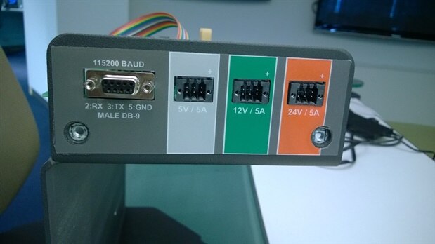

I have a robot platform powered by a 24V 20Ah battery. The platform includes three set onboard power options:
  • 24V/5A
  • 12V/5A
  • 5V/5A

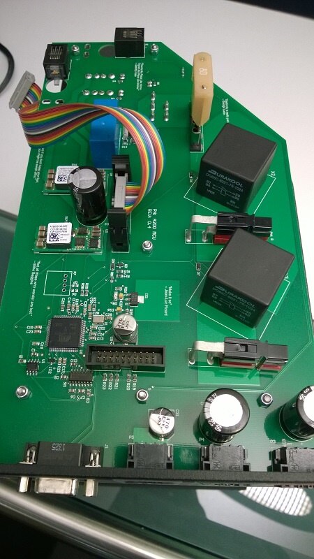

I'm not really good with power, but from my limited understanding, I should ideally have some sort of circuitry to regulate the power and avoid any sort of spikes. The robot has just this sort of solution, as shown below:
I'd like to keep the computers running from the above convenient rail, but I'm wondering what a solution might look like, to power the other components that have variable current requirements. Should I be focusing on getting the specific voltage correct to each of the components and then letting the battery supply the appropriate current, or am I supposed to keep both in mind?
If I don't have to design anything from scratch, it would make life easier, but I'm game for anything, really.
