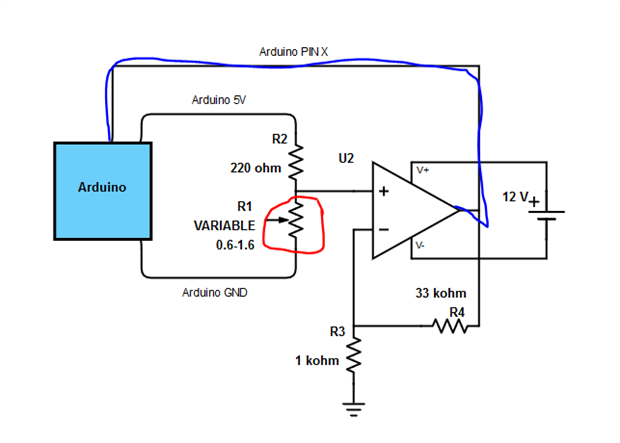

I want to measure a resistance of about 0.4-1.6 ohms with an Arduino. I'm guessing this can't be done by a simple voltage divider because of the low resistances.
How could I achieve this? The measurement doesn't have to be very accurate. The question is pretty much about "is it less than or more than 1 ohm?".
Thanks

    I also considered the possibile usage of an opamp (a component I have never used before). I watched a couple of Youtube videos about them and this is what I came up with. The component circled in red is the resistor which I'm trying to measure. The wire marked with blue is what I would use to read the signal to the Arduino. The assumption is that this would give me a signal voltage of 0.74 - 2.95 V  to the Arduino depending on the resistance (0.6 - 1.6 ohm)
    Am I even close with this one? Would the opamp be able to convert a voltage of 0.022 - 0.087 V to 0.74 -  2.95 V smooth(ish)ly?

    I did consider this approach too, boosting the voltage with an op-amp is also a potential.. There are often many ways to skin a cat!!
    Have you tried changing the 220 ohm resistor for a lower value? That would initially increase the range of the voltage maybe even bring it into range to be measured by an analog to digital converter built into your microcontroller (a higher sample range on the adc would be beneficial. If you can choose a 10bit option over an 8bit this would be better as would 12bit. Im not certain what range the Arduino has?).
    Changing the 220ohm resistor for a lower value seems a good idea to start with, this will increase the "baseline" voltage, choosing right the baseline can be increased from 0.022v to 0.74v(or within reasonable parameters.) This leaves the differential range the same so there would still only be a very slight change when the variable resistors value changes.
    What is the nature of the variable resistance? is it an actual variable resistor or something else? maybe there's a bit of trickery we can do without needing op-amps or transistors..

    The arduino UNO already has an analogue comparator that can be used for this, use one end connected to a set point (Perhaps from a PWM output with an RC to emulate an 8bit DAC or simply a resistor divider, then the comparator will trip once the threshold is reached, knowing the value of the DAC will indicate if the resistor is above or below the threshold to a roughly 1% accuracy. selecting the right resistors to produce say 0 - 1V output and then the 1R + some other value to limit the current can be used for the other input
    No external op amp needed in this case
    alternate and probably easier is to use a resistor divider with the target resistor in question as part of this. Set the VREF to the ADC to be the 1.1V reference, not the 5V reference (Default). this will give you far better resolution at the low voltage end.
    the arduino has a 10bit ADC so 0 - 1023 value which equates to roughly 1mV per count (Assuming the 1.1V VREF)
    so a 100R in series with 1R and 5V across the two will result in 5v/101R = 50mA, this across the1R gives 50mV
    a 0.5R will give about 25mV
    1.5R will give 75mV
    the mV equate to the rough count given from the ADC
    Yes your working in the low end of the ADC but given your not interested in accurate measurement of the resistor, just a rough go/no go test, this should be more than enough
    if you want a better resolution then you could drop the resistor to say 50ohms which will give roughly 100mA through the divider and so 1R = 100mV (Roughly), 150mV = 1R5, 50mV = 0R5
    Not bad for just the addition of a single resistor

    I'm going to test it with a few different resistance values and see if it could actually be possible with just a voltage divider. I just don't want to go too low with the resistance as it would increase the current draw, would it not? With a 100 ohm resistor I could get 0.048 to 0.189 volts. That might just be enough for the Arduino to detect it (10 bit ADC). Could go 59 ohms and get 0.081 to 0.317 V, which would certainly be enough, I guess, but that's 200 milliamps at 12 volts. Then again, I dont need to have the detection on for a long time. We'll see what happens...
    The variable resistance is a heating element which changes resistance as it heats up. I measured it with a multimeter to be 0.4 ohms when cold and about 1.6 ohms when "hot enough".

    I totally forgot about the 1.1V VREF of the Arduino. I have a much better feeling of this working now.

    Just tried it with a 100 ohm resistor and set the Arduino's analog reference to 1.1V, and it worked fine! I used a 12 volt source, though. I just read the analog pin and for my purposes, when the analogRead value is larger than 53, the resistor is at the correct value.
    Thank you so much, guys!
