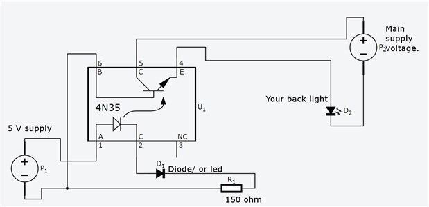

    0 supper_slash over 10 years ago in reply to mcb1

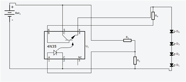

    Here is an idea of what you are doing. image
    Are you sure your led/diode is connected the correct way?
    Just a thought.
    P.S. I know the ground is connected, I just forgot to add that to the diagram.
    Also, Please take Voltage readings for ground, and each "LEG" of the circuit, This will be most helpful.
    I.E. reading at pin 2, than at pin3, resistor, then at diode/Led, both sides, etc.

    0 mcb1 over 10 years ago in reply to supper_slash
    supper_slash
    Great circuit but the Base of the transistor remains unconnected.
    ie Pin 6 is either unconnected or in some case tied to Pin 4 via a 1Mohm resistor.

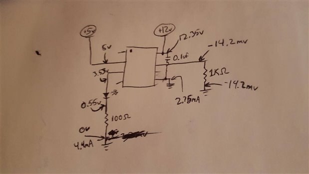

    Yes, my power supply turns on, and yes, the LED turns on.
    I have jotted down a crude schematic of what I currently have connected. This is the FOD3184 chip. One interesting thing I noted here is that operating the LED generated slight negative voltage on the ground of one side, but not the other. There was no voltage being output by the sensor side of the coupler at all, as when I disconnected it, I got 0 on the output.
    Here's my schematic with my voltage and amperage readings, and the link to the full-resolution
    http://puu.sh/mMi2D/d4665b25e5.jpg

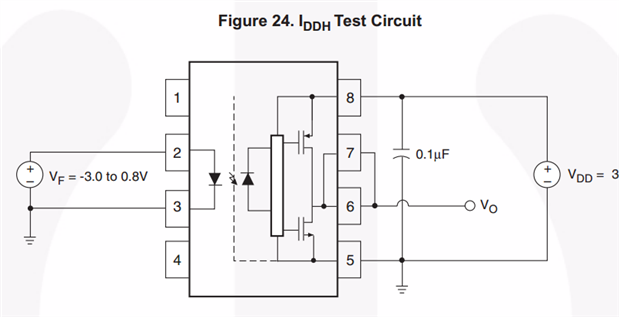

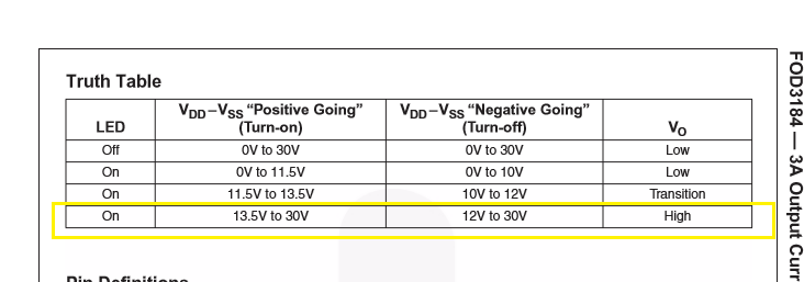

    supper_slash is right. Remove all the connections first and check if opto coupler is working fine by giving input and checking out on Vo using multi meter. Most of the times when the circuit is not working I found that a floating ground pin was the fault. so carefully connect all ground connections.
    On the second thought: Hey, look what I found:-
    So you need to apply more voltage on VDD to turn the Vo pin high. Apply at least 13.5v-14v on VDD pin.
    Hope this helps.

    0 mcb1 over 10 years ago in reply to bwarren97
    bwarren97
    Clearly some comments are missing the point.
    You have a 1.47v drop across the LED, which is within spec.
    The second LED has a 2.98v drop across it (3.53-0.55 = 2.98).
    This is resulting in the forward current being 5.5mA
    (0.55v across 100ohms is .0055A).
    The specs show you need 10-16mA
    I suggest either find a lower forward voltage led or remove it and increase the series resistor back up to 220 ohms.
    This optocoupler has a high output current and noise immunity, hence the fairly high input requirements.
    0 mcb1 over 10 years ago in reply to mcb1
    bwarren97
    BTW you are looking for 1-1.6v acrss the 100 ohm resistor if you change the LED.
    Generally the higher output/brighter LED's require a higher forward voltage, so look for some lowly old red LED.

    So, this was starting to make a lot more sense to me. However, I tried both switching the LED and removing it altogether. Still nothing
    I got a reading of just over 10mA using the lower power LED, and got a reading of about 14mA when I removed it and increased the resistor. The output on the optocoupler remained 0.

    0 mudz over 10 years ago in reply to bwarren97
    Hi bwarren97
    If you move to post number 30 (i.e. first post in this page & leave first two lines), you'll know why you are not getting a high on output (Vo pin)
    It's because you are not applying enough voltage on the Vdd pin, use minimum of 13.5v.
    bwarren97
    One thing we can try to see if the Opto-coupler works.
    Leave the input side as you have it (14mA), and hook the output up to a Led and resistor.
    You can feed it from the 5v supply  (LED and 220ohm usually works.)
    This should show if it will switch.

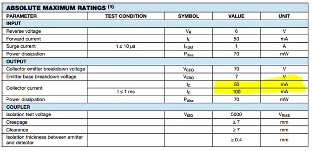

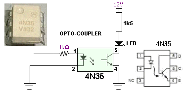

    The second part of the above test is to remove the connection to VDD (ground) from the Opto (Pin 5). This will allow the Vo output to rise or fall.
    In the end a 4N35 is probably going to work out better, however it is only 100mA output current.

    The 4N35 shouldn't have a problem driving the enable pin of my backlight. I read 1.4mA being drawn from the enable pin when I connected it.
    Great let's wait until you have it and go from there ...
