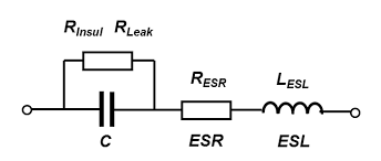

    Hi Tom,
    The 100nF and 10uF are used together, the reason is that they perform differently due to the material used in their construction (ceramic vs electrolytic). Both are advised. Figure 1 in this PDF highlights the difference http://rohmfs.rohm.com/en/products/databook/applinote/ic/power/switching_regulator/cera_cap_appli-e.pdf

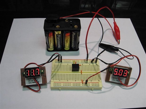

    0 jw0752 over 10 years ago in reply to sawik123
    Hi Tomasz,
    For the fun of it I put 8 used AA batteries in a pack and powered a 5 V Recom Converter. Here is a picture of the set up. The little voltmeters each draw 20 mA.
    I did not put any capacitors on the input or output in this case.
    • Reject Answer
