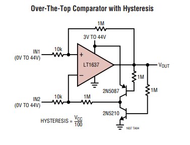

I'm looking for a solution which able to switching between a 28Vcc (state 1) and an open output (state 0), by a command signal of 200mV
When U>200mV is applied, that energize a relay which permit to supplied a 28V or let a 28V goes through itself.
When U<200mv is applied, relay is OFF, output is open.
I think it's possible to amplify the source signal before be able to command a relay.

    dougw over 7 years ago +3 suggested
    You could do this with a 30V rail-to-rail op-amp like an OPA171 or an LT1637. If the current needs to be higher than the op-amp can supply, you can use a FET on the output.
    dougw over 7 years ago in reply to jimmyhu78 +3 suggested
    Diagram:

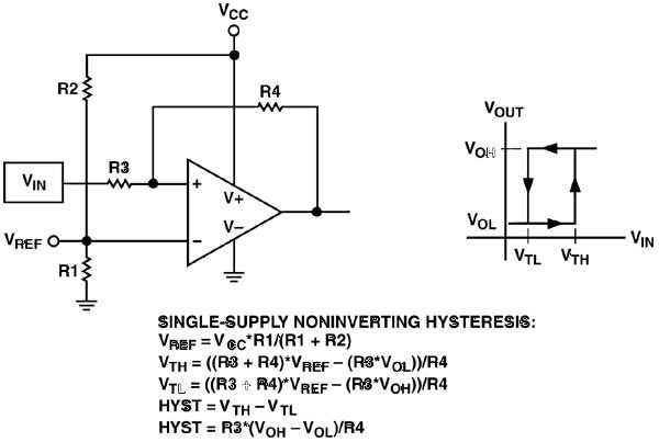

    jw0752 over 7 years ago +2 suggested
    Hi Jimmy, I think a comparator circuit like I just used in my recent Interface Build might work. You will have to use a better comparator than the LM 393 or you could use a rail to rail op amp. Don't forget…

    Hi Jimmy,
    I think a comparator circuit like I just used in my recent Interface Build might work. You will have to use a better comparator than the LM 393 or you could use a rail to rail op amp. Don't forget you will probably need some hysteresis or you will get chattering at or near the 200 mV level as the circuit tries to decide whether it should be high or low. This means that the circuit will go high at say 200 mV but will not go low again until the signal drops below 190 mV. Here is a link to my blog with the schematic. In my case the trigger point is set by the 2 10K resistors on the non-inverting + pin 3 of the comparator at 1/2 Vcc. You will have to use a resistor voltage divider to move the trigger voltage to 200 mV if that is the level you are looking to be the change over point from High to Low.
    https://www.element14.com/community/people/jw0752/blog/2018/11/27/back-up-battery-failure-inspires-new-test-tools
    If this isn't what you are looking for give the guys some more specifics and someone will come up with other ideas.

    0 jimmyhu78 over 7 years ago
    Hi Douglas and John.
    Thanks for your answers.
    If i understand well, i should use the component recommanded by Douglas, but could be safer with a Hysteresis application (as John mentionned).
    Do you think i can obtained good results with one of these kind of configurations?

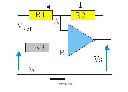

    0 dougw over 7 years ago in reply to jimmyhu78
    Diagram:
