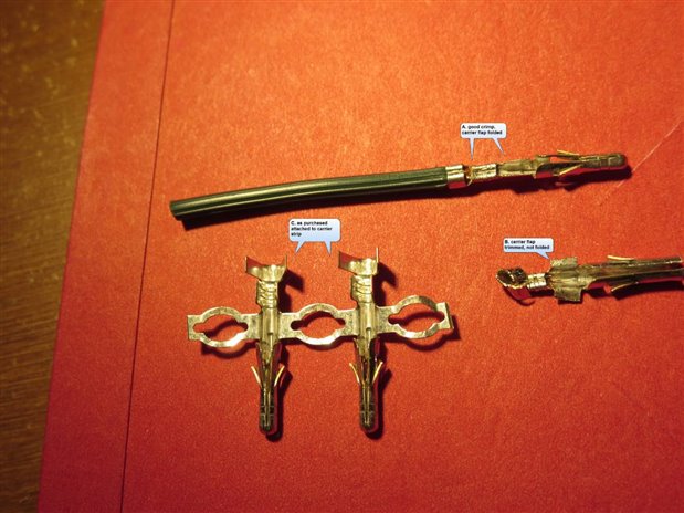

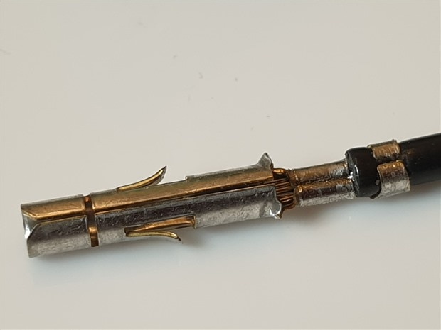

I am a self taught pin crimper.  Sounds like a personal problem, I know.
I have a crimper tool that looks like this:
I use it to crimp pins for proto board soldered wire-to-board connectors that look like this:
At first, I was unhappy with the results due to the following results:
  • The wires would stab through the hole blocking the male end
  • I’d lose the pin from it falling off the cable before I could crimp it
  • the pins are hard to seat into the connector
  • the pins back out of the connector when connected to the male end
  • the wire breaks off at the base of the pin
  • the male pins would not want to stab into the female after everything was crimped and ready
<EDIT:  See this post below for the crowd improved troubleshooting guide:  https://www.element14.com/community/message/284233/l/re-my-pin-crimping-tips-what-are-yours#284233 >
Here's how I adjusted my approach:
IssueSolution
Wires stabbing through the holeI bend the wires back over the insulation
Dropping the pinI’d pre crimp the bottom with just my fingers to hold it in place.
Hard to seatAfter crimping the bottom of the crimp pin to the cable sheathing, I take a small plier to shape the female tip to remove any parts sticking out impeding entry into the plastic connector housing.
pins back outAfter adjusting the pin shape in the previous step, I pull up the tab that will catch inside the connector to prevent it from backing out.
the wire breaks offI stopped using jumper cables as the donor wire.  Instead, I use ribbon cable.
Male pins not fittingI use a single jumper male pin to pre stab in the female pins I just inserted into the connector to open it back up.
I now get reasonable results, but what bothers me is that I have to do all this.  I would think I could just crimp and insert and be done.
So, my question is, what are the community members experiences, steps, and tricks for using crimp pins?
Thanks,
Sean

    @Sean As you'll see from Frank's link, bending the inner back over the insulation is wrong. It sounds to me as if you are using the wrong tool for the crimp, and stripping off too much insulation.
    The long stripped section is why you are poking the wire in too far.
    I suspect that backing out is caused by deforming the whole crimp, usually due to using the wrong tool.
    Having said all that, some crimps are just plain difficult, and unless you can afford a real tool (typically over £200 for once from the connector manufacturer) best left alone.
    I've had reasonable results with Molex KK types and Amp using cheapo tools.

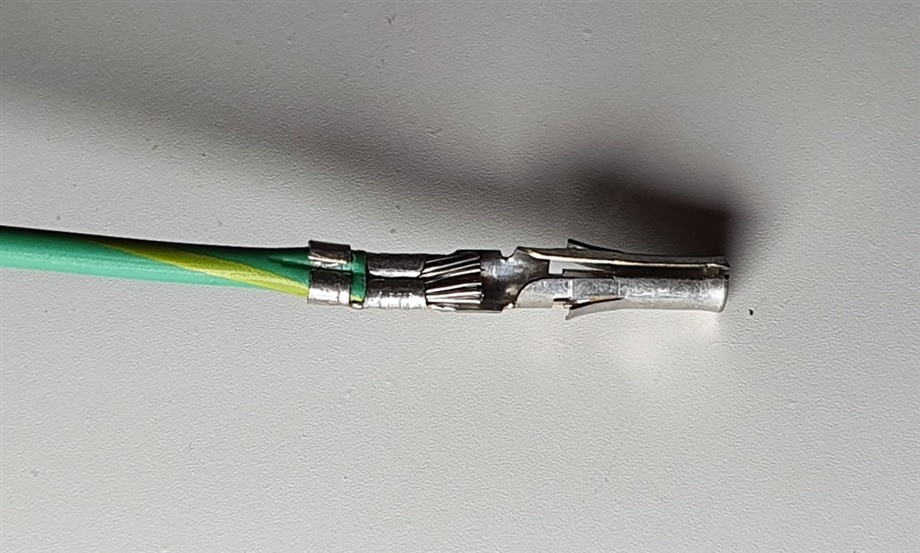

    Thanks for linking that thread, Frank.  All that shop talk was happening on my birthday.  Funny thing was, I was probably trying to crimp pins and missed it.
    Looks like the one twist I had from Shabaz's guide is how to use the second crimp zone.  I had evolved to bend the bare wire back on the insulation and use both crimp zones to grab the insulation to prevent the wire from breaking and to get more copper surface area contacted.  To see how they are mass produced, I just destroyed a store bought cable and did indeed find that the second crimp zone should be nothing but raw copper wire.  So, I updated my troubleshooting chart below.  Note, its not just for DuPont pins in mind, but variations.
    Pin Crimping Troubleshooting Guide
    Issue
    Solution
    Wires stabbing through the holeCut off enough insulation such that the cable insulation will sit at the base (outer) crimp zone and raw copper will be crimped in the next zone. If you have excess, "Double up" the excess to the raw copper zone or trim it to fit.  See next issue to prevent it from slipping forward prior to crimping.
    Dropping the pinPaying close attention to orientation of the pin in the jaws (it's designed to fit only one way), squeeze the pin by itself until one ratchet click.  Then, insert the wire.  Make sure the copper isn't too long, then squeeze all the way.
    Hard to seat in the housing
    The standard crimping tool is designed to go one way.  It has a recess on one so that the lower section of the pin crimps with a bigger diameter to accomodate for the insulation.  The upper section of the crimper jaw has a smaller diameter to grab the bare wire.  So, its imperative that you place the pin in the crimper such that each section is aligned with the tool correctly and no pin section overlap occurs in the center.  If not, you'll deform the pin such that it will give unpredictable results when trying to slide in the housing.
    If the pin is so small that it fits inside the width of the crimper, then you need to switch to a different style crimper such as the PA-09.  That style crimper doesn't have the offset and is designed to first squeeze the base of the pin at the insulation and then squeeze again at the next crimp section that is at the bare wire.
    After crimping, gently push the pin into its housing observing where any clearance issues may be.  If needed, take a small plier to shape any parts sticking out impeding entry.  This may be the case for the smaller pins or if your tool is slightly oversized than the pin your crimping.
    pins back out when making final connectionDepending on the pin, there may or may not be a tab that will click into an opening visible of its connector housing.  That needs pulled out a little if you did not get a confirmational click.  Other problems could be you simply have not inserted it all the way in so that the catch mechanism has had a chance to click into place.  Use a small flat tipped screwdriver to push the pin at its base into the housing further.  You may need to put the pin under a microscope to fully understand the latching design.  Note, most pins are designed to be oriented one way in the housing.  Getting this backwards will definitely cause it to push back out.
    the wire breaks off
    Some cables are designed to be very flexible, but require pins that provide substantial crimp contact area as well as a connector housing that provides stress relief (example, DuPont pins on jumper cable).  Such cables do poorly for pins that have tiny crimp contact area and no stress relief.  For these, try ribbon cable instead or provide stress relief using heat shrink over the crimp zone of each pin and outward at least 1/2".
    In general, don't over squeeze or squeeze too quickly as it can snap the insulation section.
    Male pins not fittingFor connectors used on 0.1" pitch headers, such as the Raspberry Pi, you may use a single jumper male pin to pre stab in the female pins prior to final assembly of the connector.  This will correct any distortions that may have occurred in the crimping process.  For other connectors, try a single male header pin to work each female pin individually.
    All otherPractice, Practice, Practice!
    After reading the other thread, coupled to my own experiences, I now feel confident I'm on the right track.  I had a good project yesterday that gave me plenty of practice on an assortment of the cheap chinese pins.  The results were custom sized, strong wire-to-board connectors that cleaned up the inside of the enclosure and are ready for the field.  The project will measure vessel growth due to thermal expansion over a 30 hour operational cycle.  This will allow me to locate vessel attachments without concern of clearance issues with its surroundings.

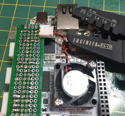

    0 shabaz over 7 years ago
    Hi Sean,
    I've not found a universal tool, but I've got about three different ones, and between them I've so far got repeatable results for a good range of crimps. I'm sure there's other low-cost tools that are just as good or better, these are merely the ones I'm using:
    For the 0.1" pitch header pin sockets or pins, I'm at 100% repeatable results (unless I'm extremely careless) with the HT-225DHT-225D tool (some photos of how to use the tool, and the results on 0.1" crimps are in that other thread that Frank mentioned).
    It's also fine for other similarly-sized, and larger pins or sockets - it gives superb results with MATE'N'LOK crimps too (again 100% repeatable, with what looks to me like a great crimp and grip on the insulation; see photo below), which are intended for up to 19A.
    For smaller than 0.1" pitch, e.g. JST ZH (as used on the BeagleBone-AI serial connector) then I had to resort to a PA-09 tool. That's a fairly low-cost tool, which is useful for the extremely small crimps (like 2mm pitch). It can do 0.1" pitch too, but HT-225DHT-225D is better for those since that has a proper ratchet action and simultaneously does the insulation as well as the conductor. With the PA-09, they have to be done separately.
    Finally from Fry's I've got this crimp tool: https://www.frys.com/product/1922790 which is sometimes handy if there's some unusual connector. It is intended for D-sub connectors but works with other stuff. I prefer the HT-225DHT-225D overall though.
    Here's how I try to resolve the issues you mention:
    1. Better accuracy with wire strip length, so that the wire doesn't go into the wrong area. Something like the Stripmaster LiteStripmaster Lite is great for thinner wires, or the Knipex tool here: Knipex Precision Wire Insulation Strippers Review - Model 12 12 06  because they strip the insulation fairly square, and repeatably. The Knipex tool has a depth stop, and I think the Stripmaster Lite may have that as an optional extra (otherwise it should be easy to 3D-print an attachment for it). The photo above shows a wire that was stripped with the Knipex tool, and the insulation is cut very square. I didn't set the depth stop correctly since the wire is protruding by about 1mm into the space where it shouldn't, but I don't think that has an impact for this particular connector. If the wire is extremely thin, then I may fold back and double the wire, but not over the insulation.
    2. I have no real solution to this, except either crimping the ratchet by one or two clicks so that the crimp is held in place and then I only need one hand on the tool and one hand guiding in the wire, or putting light pressure on the tool so that the crimp is held in place. In other words, the crimp is solely held by the tool, and that leaves me with one hand free to then insert the wire. With the HT-225DHT-225D, I can tell when the wire is inserted in to the correct depth, because I hold the tool at an angle and guide in the wire until I see a glint of the wire from the other side. Somehow that's quite repeatable, although it sounds like it shouldn't be : )
    3. I use your solution. It does sometimes happen, if the wire insulation is thicker than will easily fit into the plastic housing.
    4. This doesn't happen much, but your solution seems good (or push the latching plastic on the shell in slightly, if the shell has that feature.
    5. So far I don't see this issue too often, but for single jumper wires I like using heatshrink.
    6. So far I've not encountered this much (usually the crimp tool won't affect the working end of the crimp) but the solutions you mention seem good.

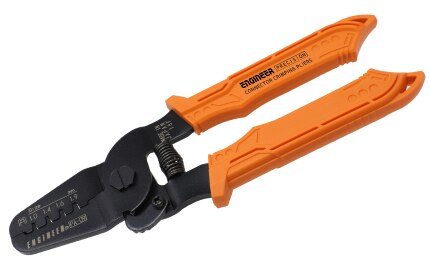

    I personally tried about 3 types of crimp tools (mentioned above and in the linked discussion) in addition to just small pliers. However, I don't always have original DuPont connectors and even small differences mean crimping might go wrong. Or the crimp looks OK, but the connector can't be inserted to the housing.
    I haven't seen anyone recommending Engineer's crimp tools: ENGINEER INC. - PRECISION CONNECTOR CRIMPING PLIERS FOR NARROW-PITCH AND UNIVERSAL CRIMPING
    It is a universal tool, have a look at the application guide: ENGINEER INC. - PRECISION CONNECTOR CRIMPING PLIERS FOR NARROW-PITCH AND UNIVERSAL CRIMPING
    It costs about €60. I use it for 2.54 mm connectors, but also made great crimps of JST 1.5 mm, 2.0 mm, 2.5 mm connectors. Specialized crimp tools for just one or two types were offered to us at work for about € 300.
    The downside is, you need to crimp every connector twice, the inner conductor first, the insulated part second.
    David
