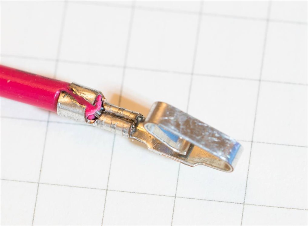

I am a self taught pin crimper.  Sounds like a personal problem, I know.
I have a crimper tool that looks like this:
I use it to crimp pins for proto board soldered wire-to-board connectors that look like this:
At first, I was unhappy with the results due to the following results:
  • The wires would stab through the hole blocking the male end
  • I’d lose the pin from it falling off the cable before I could crimp it
  • the pins are hard to seat into the connector
  • the pins back out of the connector when connected to the male end
  • the wire breaks off at the base of the pin
  • the male pins would not want to stab into the female after everything was crimped and ready
<EDIT:  See this post below for the crowd improved troubleshooting guide:  https://www.element14.com/community/message/284233/l/re-my-pin-crimping-tips-what-are-yours#284233 >
Here's how I adjusted my approach:
IssueSolution
Wires stabbing through the holeI bend the wires back over the insulation
Dropping the pinI’d pre crimp the bottom with just my fingers to hold it in place.
Hard to seatAfter crimping the bottom of the crimp pin to the cable sheathing, I take a small plier to shape the female tip to remove any parts sticking out impeding entry into the plastic connector housing.
pins back outAfter adjusting the pin shape in the previous step, I pull up the tab that will catch inside the connector to prevent it from backing out.
the wire breaks offI stopped using jumper cables as the donor wire.  Instead, I use ribbon cable.
Male pins not fittingI use a single jumper male pin to pre stab in the female pins I just inserted into the connector to open it back up.
I now get reasonable results, but what bothers me is that I have to do all this.  I would think I could just crimp and insert and be done.
So, my question is, what are the community members experiences, steps, and tricks for using crimp pins?
Thanks,
Sean

    That's a good link , Frank. @Sean As you'll see from Frank's link, bending the inner back over the insulation is wrong. It sounds to me as if you are using the wrong tool for the crimp, and stripping off…

    I bought these Engineers tools.  I make just as much of a hash of crimping things with htese as with any other tools to be honest.   My best tip for crimping is -- don't bother, buy pre-crimped wires.   At least, specifically, I do a lot of work with Molex PicoBlade stuff and these pins are absolutely minute.  The pre-crimped wires are eyewaterinly expensive, but worrk out efficient when I consider my time and annoyance level at trying to crimp these myself.
    Getting just the correct length of conductor exposed appears to be incredibly important too.  With very much sub-millimetre precision.  If the conductor is too long, it'll sit inside the crimp contact and cause issues when inserting the resultant crimped pin in to the mating connector.
    Getting the force correct is also incredibly difficult -- insufficient crimping forrce means the thing falls apart, obviously.   Too much force can easily mangle the crimp pin and it either immediately breaks in half, or fails quckly in use.
    The whole crimping game is a total nightmare as far as I'm concerned.  Buy pre-crimped leads.

    Sometimes I do want custom cables though, and especially when they are the larger ones (like 0.1" pin headers) then the crimp tools (at least the ratcheting one mentioned above) can perform a reliable job just as good or better than ready-crimped 0.1" header wires. I find it satisfying making nicer perfect-length cables and then using heat-shrink than those single 0.1" shells - admittedly not a very productive thing to do though!

    I couldn't wait until Christmas.  I got those PA-09 pair of crimpers.  They were the missing link!  Thanks, David.
    For my small pins pictured in my original post, they wouldn't fit into the ratcheting style crimper where they needed to.  I was unknowingly cheating them to get it to somewhat work.  The ratcheting style has a stepped die to crimp the insulated section wider than the bare wire.  In turn, no matter how you try to fit a small pin there, it would deform the pin.
    The PA-09's allow you to crimp each section at a time without coming into contact with anything else.  In turn, a perfect crimp.
    My learnings through this Discussion are:
    • for bigger pins like DuPont pins, use the ratcheting style for speed, or get the PA-20 & PA-21.
    • for small pins, get the PA-09.
    • cheap bulk pins and connectors do work great with the right size crimper
    • For both types, do the one-handed insertion method.  Pre-squeeze the pin which frees up your hand to insert.
    So, for hobbyists, for about $100, you can get the two types of crimpers and a life time supply of connectors.  Now that would be a good Christmas present!

    Just noticed I'd had some KK contacts, so I tried that with the HT-225DHT-225D too. The result seems reasonable.
    (this is 22 AWG wire, quite thick insulation). I'll try to see what other crimp terminals I have, to see what works and what doesn't work (all 0.1" and upward, since smaller ones don't work with that tool).  Unfortunately this data-point becomes less useful though if different wire thicknesses or insulation thicknesses are used, so I'll have to dig out some different wire types too.
