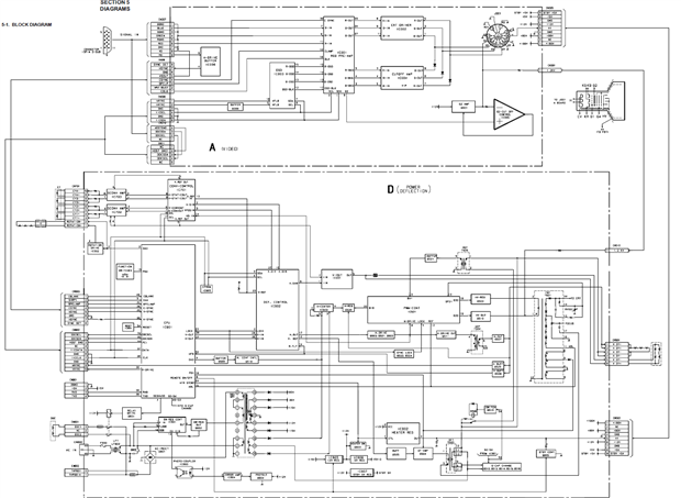

hi i dont know much about crt tubes at all but im looking to build a crt arcade unit but alot of crt tvs and screens i find seem to be completly useless i was hoping there might allready be an option but would there be any point in trying to create a crt driver board or the deflector circut ? (to controll the yolk and electron gun )that accepts av and rgb inputs.
hoping this isnt a fools idea

    I don't know your experience in electronics. The old CRT monitor has been obsolete for decades. There is no single chip in which you can build everything in one. Such a CRT monitor needs some 1000V, starting…

    This is not an easy problem to solve.
    What resolution do you need.
    I would look at some old VGA board drivers, they provide you with most of the basic circuits.
    You need high voltage to directly control the yolk deflection coils. Please be very careful, those levels can kill.
    The electron gun is a lower control voltage, if you check the VGA designs, they were all TTL for the RGB inputs.
    The short answer is yes  you can, but unless you know what you are doing, no you should not attempt.
    When I went through Tech school fifty years ago, we were taught how to work with CRT voltages. I would consider that level of training as the minimum needed to work with the voltages.

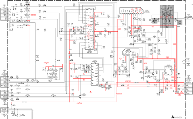

    Have found a Texas Instruments RGB Crt video design guide working thru the board schematics for the
    TI LM1203NLM1203N RGB preamplifier and the TI LM2419 Crt Driver ICs  so im hoping this will be a good start there design included
    contrast control, brightness control, cutoff adjustment, delta gain adjustment (for white balance) and blanking
