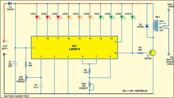

     I was wondering, im building a raspberry pi laptop, and I need a way to tell if the battery is low. so, what part would I need to get if I get 2 LED'S, and I want the blue one to be on if the battery is full and the amber one to be on if it gets below 4.5 volts (with a 7.5 volt battery) OR if I have a multi-colored one how would I do it if the same thing applies except with a multi colored one. thx in advanced.

    Hi Alex, I have found the circuit that will help you , it uses The LM 3914 it has ten comparators, which are internally assembled in the voltage divider network based on the current-division rule. So it…

    This type of thing is possible to implement using comparator ICs and a voltage reference. For example, see the datasheet for LM3915 which has a block diagram of the type of circuitry that would do what you need. Another alternative - if you're using something like an Arduino as part of your build - would be to use one of the ADC channels to monitor a fraction of the supply voltage and control the LEDs.

    I don't know of any links to do exactly what you wish to achieve, but the LM3915 datasheet has a block diagram to give you an idea of how to achieve it with a comparator. You'd still have to design the circuit. Similarly for an ADC method, you could search for potential divider to see how to divide the input voltage to a range suitable for the Arduino ADC (assuming this is what you choose - just a suggestion in case you were already using it as part of your design). Code to read the ADC can be found by searching for 'arduino adc' - it is an AnalogRead function. To make an LED turn on, the DigitalWrite function can be used I believe (I'm not knowledgeable on Arduino, but I know it can be done with it - the arduino.cc website has example code).

    I have found the circuit that will help you , it uses The LM 3914 it has ten comparators, which are internally assembled in the voltage divider network based on the current-division rule. So it divides the battery level into ten parts !!
    you can read more about this circuit at http://www.electronicsforu.com/electronicsforu/circuitarchives/view_article.asp?sno=137&article_type=1&id=433&tt=unhot&b_type=new

    The LM3914 is basically a Dot/Bar Display Driver used for indication of voltage levels, You can read more about it HERE...
