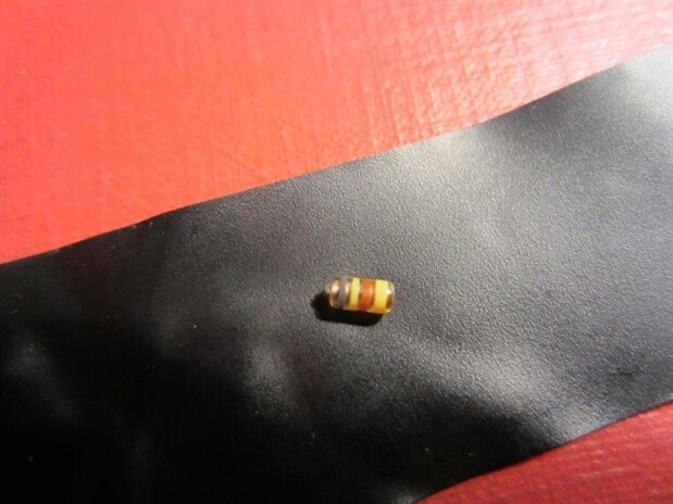

Any clues what diode this is, and value
Many Thanksimage

    it is not possible to say, but if you have saw waveform, like +-10V, connect to diode via 1k resistor, diode voltage to X input and ramp voltage on resistor to Y input of oscilloscope, and you will get VI curve. and by that you can tel if it normal diode, zener, or Schottky

    0 shabaz over 11 years ago
    It's (99.9% likely) just 1N4148 which is a super-popular diode. (Fat yellow, then brown then yellow then gray stripes).
    Your replacement is likely to come with wire legs, and possibly uncolored except for one band which I think is to be positioned where the fat band is.
    If your current device works, that's easy to test with a multimeter.

    0 Former Member over 11 years ago in reply to Kilohercas
    Many thanks - I try and give it a go
  • Former Member
    0 Former Member over 11 years ago in reply to shabaz
    Yes this one it have wire legs before but it pop of the circuit board after being in a flood.
    Trying to rebuilt the cicuit board. I have some 1N4148 so I will give it a go. Many thanks
  • Kilohercas
    0 Kilohercas over 11 years ago in reply to Former Member
    best way to tell what is it, is where you removed it from. sometimes it is obvious

    0 michaelwylie over 11 years ago
    Look up the diode color codes. It's most likely an 1N4348. I'm reading the second colour as orange, not brown. If it's brown, it's a 1N4148.
