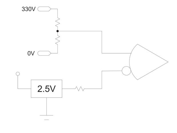

    Hi, I'm back.  Let me say that you are brave for starting off in HV, something I've avoided for years.  An LED is not a good electrical match for 330 V.  You should either establish an LV, or use an incandescent or neon bulb to establish a visual indicator.  Let's suppose we are going to use a resistor to ballast an imaginary indicator LED.  Let's say that our current through the LED should be 30mA and its drop is 1.2V, consistent with a red LED.  The amount of power our LED is using is the product, 36mW.*  The drop across the ballast is 330 - 1.2V, 328.8V.  328.8 / 1.2 = 274.  That's how much more power the ballast is using as regards the LED.  The ballast uses almost 10W!  There are other reasons to go to an auxiliary LV as well.  I will presume a 5V LV, as a design point of departure.
    Can you make sense of this circuit as I have drawn it so far?  Assume 0V and gnd are connected.

    Thanks for helping me out Don image I think you are right about HV, so i wil try using LV capasitors for my project. Thanks! image

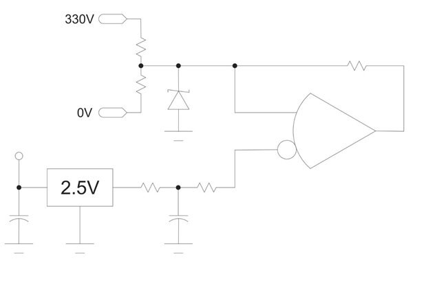

  • D_Hersey
    0 D_Hersey over 12 years ago

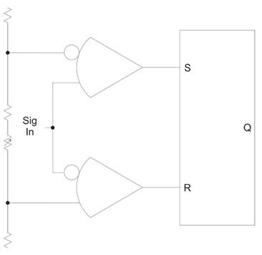

    The feedback resistor should be >> than rA || rB.  The point of the Schmidt Trigger is to bias the switching points away from each other.  The motive is to avoid chattering.  The thermostat on your air-conditioner probably has such a faculty.  They are typically used when we have a bang/bang device trying to stabilize a continuous quantity.  Presuming RRIO, the points can be computed by analyzing with the feedback resistor in shunt with rA then rB.  If we were interfacing to an A/D convertor, rather than a banger, we would use negative feedback for stability.  Remember, all other factors being equal, Negative feedback tends toward stability.  Positive feedback tends toward saturation or oscillation.
    The Japanese have a charming, illustrative term for the behavior of an ill-tempered comparator, they use the word 'hunting.'
    There is another form of the Schmidt trigger circuit that allows for independent setting of the cross-points, it uses two comparators and an S/R flip-flop.  Note: the gates for the flop can be constructed out of the remaining comparators of a quad, if no spare gates are laying about.

    0 jw0752 over 12 years ago in reply to D_Hersey
    Hi Don,
    Sorry I jumped into your tutorial to Magnus but I always learn something when I do. Your first drawing didn't come through clearly to my computer and perhaps not to Magnus's either. Your second drawing is all there and makes more sense. I liked your reference to "hunting" as I learned this term years ago in reference to a gasoline engine that doesn't run steady but pulses its RPMs. It would relate to an unstable oscillator. Back to your circuit why wouldn't a person just use a segment of a 74HC14 and use an input voltage of the resistive voltage divider to trigger the Schmitt Trigger. The hysteresis of the 74HC14 would eliminate LED chatter. Obviously we would need a stable 5 volt power supply to power the 74HC14 and the LED. Perhaps we would also need a zenner diode to provide some protection to the input of the IC in case of transients from whatever circuit he is using to charge the capacitor. I submit these ideas humbly as I can tell from your post that you are way ahead of me in electronics competence. Please continue your tutorial as I am interested in this question. It seems like something that could be useful to me in the future.
