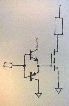

  • D_Hersey
    0 D_Hersey over 11 years ago
    The ZUNL110A is enhancement-mode, practically all mosfets are.
    --Pardon the jaggedness, way way too much 425 today--
    This is how you make a mosfet switch quickly.  That resistor business doesn't make a lot of sense, a capacitor opposes delta V.  Its only like 100pF to 1nF, so its not like we need an inrush limiter or something.  I stole this from here:  http://www.amazon.com/Practical-Switching-Supply-Motorola-Electronics/dp/0121370305 use it if you are PWM-ing, it works great and it's cheap.

    Ringing can only occur on the control terminal if there is inductance somewhere.  Keep the gate driver circuit close to the power Q and the control signal.  Use thick, short traces.  Consider using 2oz. board material.
