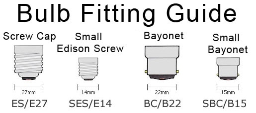

    0 14rhb over 5 years ago in reply to jw0752
    Hi John, for your info only, the E27 is a size of mains AC light bulb. In UK they used to be ES for Edison Screw, now just E and the B is used for Bayonet Cap.
