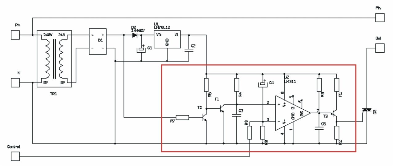

Hello,
The goal is to control thru a triac a low power 24VAC load, by a 0-10VDC setpoint
Generating a synchronizied ramp and zero crossing detection, comparating and firing the triac is well known.
BUT : is somebody knowing an IC to do that (the goal is space saving) ?
Thank you for your ideas

    Thank you for your answer Colporteur,
    I'm looking to regulate 0-24VAC with 0-10VDC, not to switch ...
    Best regards
  • Pips
    0 Pips over 3 years ago in reply to Pips
    Actually, something like that :  https://www.huimultd.com/PHASE-SHIFT_TRIGGER_MODULE/TRIAC-JKKE/  but in DIL form or SMD for low power (6W)
    Thank's

    0 Pips over 3 years ago in reply to colporteur
    Sorry Colporteur, my english is not so good. (swiss french :-))
    Actually I know very well how to do it (synchro sawtooth ramp, compararison with the set point and so on).
    My question is  : has some supplier build an integrated circuit for this function (ramp building, comparison and triac driver) ? It's just a matter of space saving on the board ... but mainly because I was asking myself about it, and I like to know things, as it is supposed to be my job as engineer ... :-)
    For information, the circuit is giving as output  Dmx signal, and a 0-10V signal. I have to add the 0 to 24VAC just for a damned bulb in a button, as I don't want to modify the whole wiring of the bulding.
    Anyway, thank you for the time you allready spent for me

    0 Pips over 3 years ago in reply to dougw
    Hello Doug,
    The application is not the matter, but if you are interested let's explain it :
    80 lamps lighting the audience in a theater.
    The original (35 years old) system was controlled by 4 buttons on several control panels : 100%, 40%, 0%, stop ... value changing from on to another following a ramp. This old system sent the reference to the dimmers as 0-10Vdc.
    I build a new system (8051 based)  keeping these buttons functions, but permetting to switch to Dmx control from the light desk.
    The new system include both set-point outputs : 0-10Vdc and Dmx, to be compatible with various dimmers. Everything works perfectly.
    It include also a curve correction thru a table in the processor.
    And now I want that the light intensity of the 100% button follow the hall intensity. And the bulding wiring is pretty messy. The control power for everything (buttons, relays, contactors, button's lamps,...) is 24Vac, with the 0/24Vac grounded ! That's why I choose to keep the control of this lamp by a regulated 24Vac as it was ...
     Thank for your help. The schematic you mentionned is harware controlled, I need to control via an analog set-point. Integrated !
