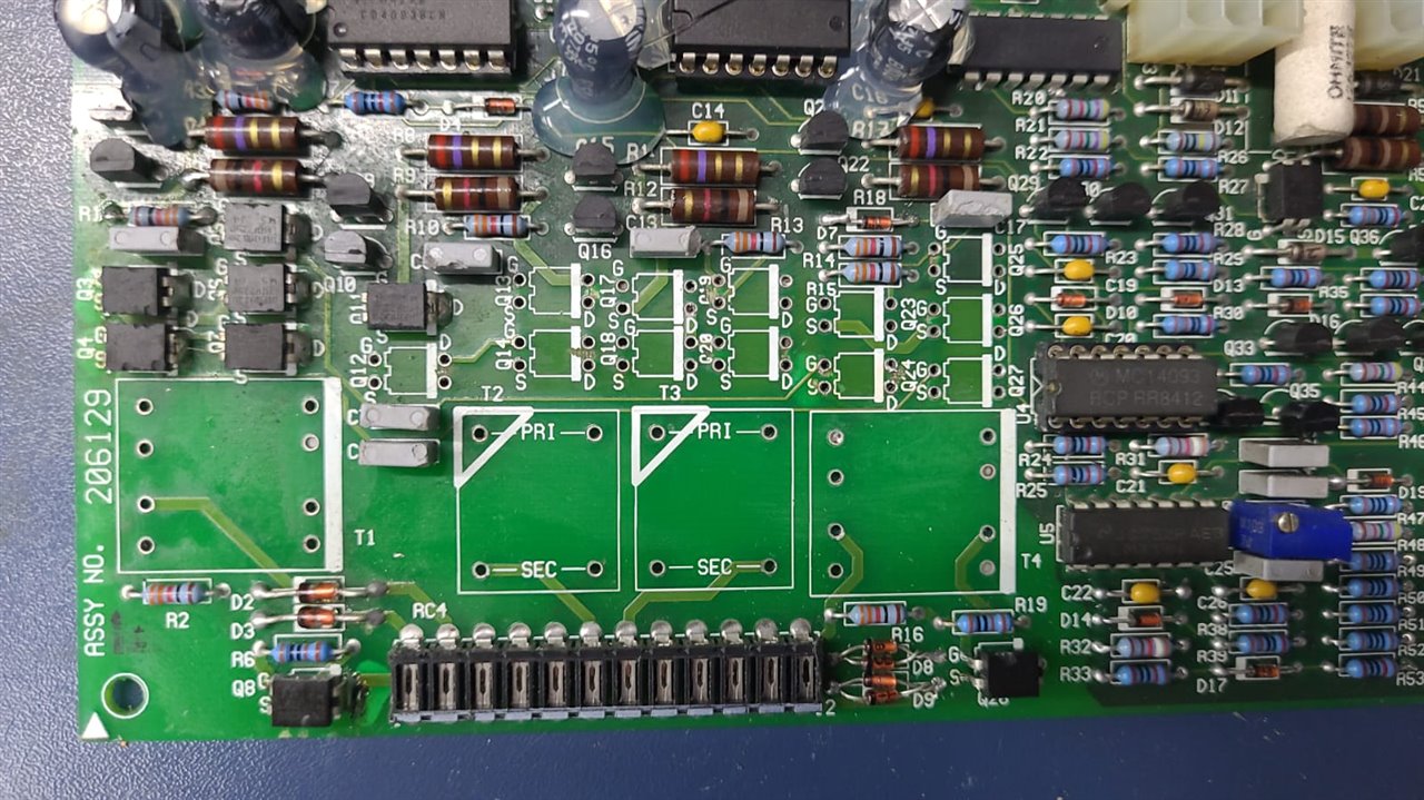

    Could please someone help me with a picture of this area below? I Just need know who is P and who is N in Q3 to Q28 MOSFETS.  Thanks so much!

    I bought this machine from a junkyard and am trying to fix it.
    First I identified some components burned internally to the PM and replaced it with 2 IGBTs, but the side referring to XFMR2 was still burning.
    Then following the technical manual identify these MOSFETs and I saw that they had been changed on another occasion by someone else.
    They are really MOSFETs and some were shorted, the P channel being the IRFD9120 and the N IRFD110.
    It could be that they are all P channel and the guy who tried to repair it previously put the wrong MOSFET.
    So, in short, I would like an image to check the correct positions in the right places.
    Thank you very much again and if you can help me I will be very happy!
    shabaz over 3 years ago in reply to Ubbi.wan
    Hi,
    The photo is too small to read the detail. Can you read and paste here the part code on the MOSFETs?
    It might be hard finding exact replacements, that shape MOSFET is not as popular nowadays. But it might be possible.

    However, could you please check resistors value R2, R1, R10, R13, R14, R15
    Also check D2, D3, D9, D8  Zenner diodes
    Q9, Q10, Q16

    I pick this picture above from ebay ( https://www.ebay.com/itm/264940051436?mkevt=1&mkcid=1&mkrid=711-53200-19255-0&campid=5338722076&customid=&toolid=10050 )
    In my original board below some MOSFETs has been removed. For this reason I need a picture with the original positions of this MOSFET's.
    Some MOSFET's is IRFD9120 - P Channel and IRFD110 - N Channel. Maybe doesn't exist N channel in original board, because this board already modified for me.
