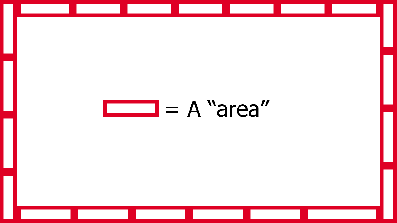

Okay this is my first time using a forum to ask something so apologies for my english and questions asking.
Whats is my project: I want to make my own controller to control LED strips for ambient lights behinde my tv. The LED's sync to what’s happening on the screen.
My plan: I want to take a hdmi input from a source (like chrome cast or gaming console), process the image and then pas the hdmi input, out to the tv, via hdmi out. To split the hdmi input to the SoC and the tv, i will use a seperate hdmi splitter, if it takes to much bandwith or prossecing power to pass trough via the SoC.
What does the image prossecing look like?: I want to take a avarage of the colors of a area. This area will be allong the sides of the screen. I also added a really ruf sketch of what i mean by area. The number of areas depend on the number of LED's around the screen. I am not sure if this is the final way i am going to do this, but this gives you a idea of what i mean by image prossecing.
To cut on procesing cost/time i think i will maybe down scale the image it needs to proccess. For example when you have a 4k image input, it needs to collect a lot of pixel color values, and take a average of them. While we maybe dont need that much detail. I dont know how far i will down scale the image, but i will know this after testing.
The qeustion: So now you know my plan, my qeustion is: What SoC should i use for this project? The main reason i ask this qeustion is because i dont know how much computing power it wil take to prosses a image this way. I know i can probably use a raspberry pi, but i also dont want to use a overpowerd SoC for this project. Also because i maybe want to produce more of these i need to think about cost.

    I have considerable experience with video processing up to around 1080p60 (not 4k). I can suggest you two ways to do this if 1080p60 is enough for you:
    1. You can use a HDMI-to-USB3 frame grabber (~10-15$ supporting ~1080p60), connected to something like a RPi or any other SBC which supports USB3. Then you can write the image processing code inside the RPi. I would say this would be the easier approach.
    2. You can use Zybo Z7-20 board, which has a HDMI input (as well as an output), and you can build your system inside the Zybo's Zynq FPGA to extract the info you need from each frame. You can also drive the LEDs by building some logic inside the FPGA fabric.
    In both cases you will need a HDMI splitter on your original source so that one output goes to the TV and the other comes to your system of choice (above). The first way will be easier but the performance might be limited (but probably still acceptable for what you need for). The second system will be blazing fast but I wouldn't recommend it if you you haven't worked with FPGAs before (or not willing to put in quite a bit of effort Slight smile )
    Hope that helps!
