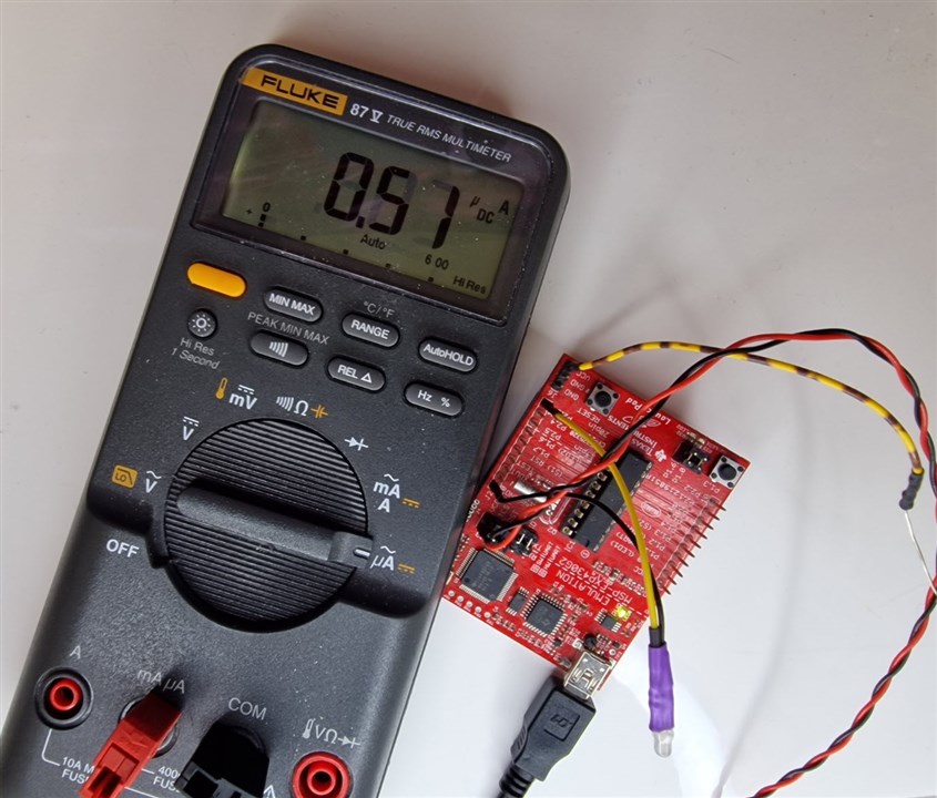

    0 shabaz over 2 years ago
    For my kitchen under-counter lighting I used an Atmel ATtiny chip, connected to a push-button, to power on/off and select several dimness levels from a single button (there may be LED flashlight chips to perform this nowadays). The kitchen circuit was not battery operated so I didn't make any effort to save energy in the microcontroller.
    Anyway this thread made me curious to see what current consumption the MSP430 would use (modern PIC might beat it, but I don't use PIC or Maxim microcontrollers, for other technical+non-technical reasons). The MSP430 chip is available in a 4x4mm package that is easy to solder (0.65mm spaced pads) and can run without any external parts (technically, just a bypass cap could be nice; but it is also helpful to add a second capacitor+resistor on the RST line, to make it easier to program in-circuit if desired).
    MSP430 is possibly no longer state-of-the-art for low-power, but it's still low (enough for years of operation, even on a coin cell).
    The part I tried (MSP430G2452) is $0.67 in 1k qty, but there's a lower Flash size version that should be cheaper (I didn't check). I used the DIP version since it plugs into the standard development board (MSP430-EXP430G2ET).
    In the setup below, the current consumption was ballpark 500nA at room temp. In theory, that chip should be able to go lower (there is a particular power mode that enables that), but that didn't work for me. I didn't spend much time on it since 500 nA is already pretty low even for some coin-cell use, and the power mode that worked is desirable for other purposes when adding features, but with the even-lower-power mode it should be possible to shave another couple of 100 nA *maybe*! But if it was that critical, I'd probably search for a more modern processor, or add more circuitry (to initially only power on the chip when the button is pressed, and then hold power to the chip with a MOSFET etc).
    Here is the MSP430 push-button code if ever needed. It has separately configurable push-on and push-off delay times. It seems to function in the very limited testing I tried, but I can't guarantee it. The code isn't very pretty (I modified some earlier code I had).
    It requires a button connected between the P1.2 pin and VCC. The active-high output (to MOSFET circuitry, or enable pin of regulator, or even directly used as an output supply rail if it is low-power) is on the P2.3 pin.
