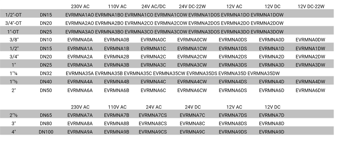

When 36W supply to specification 16W solenoid valve normally open, is there is effect to the solenoid valve?
  • Anthocyanina
    Anthocyanina over 2 years ago in reply to Afiq +5
    your valve works with 230V AC, it will not work (to specification, if at all) with a 24V power supply

    Maybe ordered the wrong one? There is a 24 V version:

    0 Anthocyanina over 2 years ago in reply to Afiq
    the issue is that you are using 10% of the rated voltage of the solenoid. the voltage drops because the solenoid is a very big load for your power supply because it is specified to work with 10 times the voltage you are using

    So, we need at least 230V to trigger the solenoid valve, and the load for power supply also specified with 230V?
  • Andrew J
    0 Andrew J over 2 years ago in reply to Afiq
    It really sounds like you should get a qualified electrician involved to look at the whole thing, not just the solenoid.  If you can’t grasp that 230v is required to drive it in spite of the label you really ought not to be working with that voltage level.  It can kill you as quick as, or anyone who looks at it in future if it isn’t installed properly.

    0 Jan Cumps over 2 years ago in reply to Andrew J
