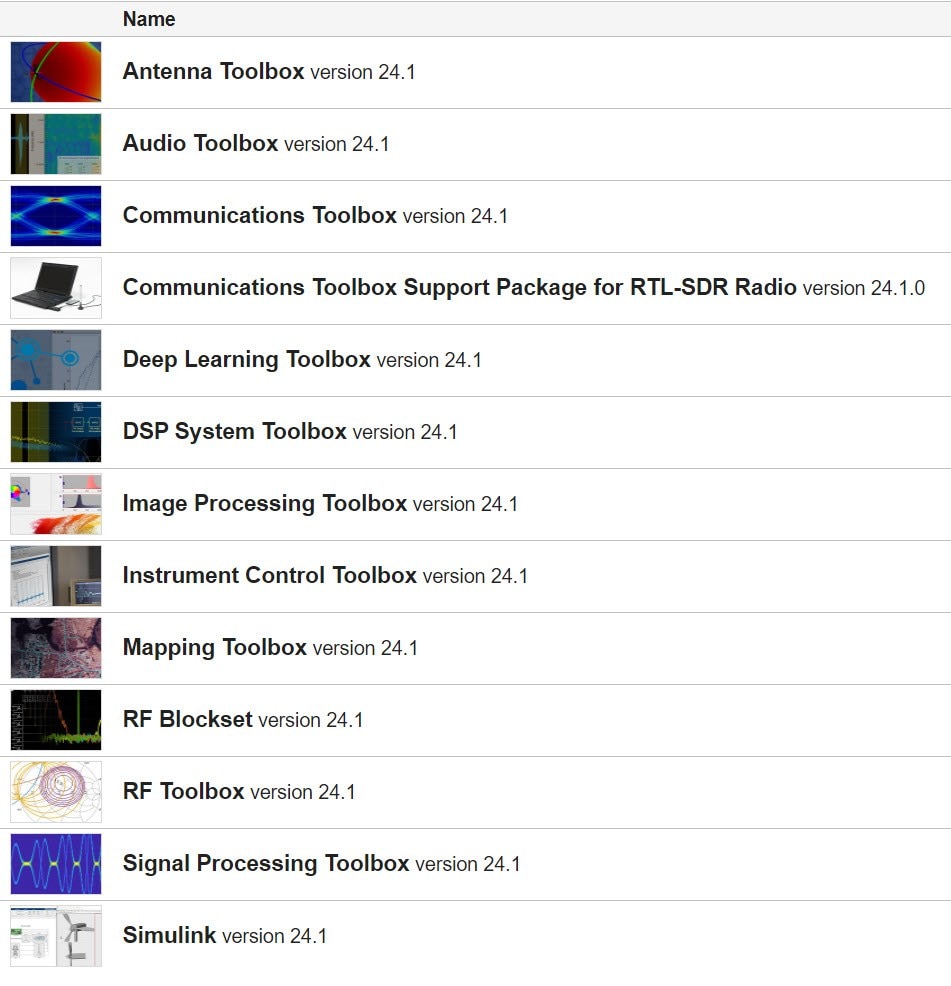

    Jan Cumps over 1 year ago
     shabaz , you own MATLAB. What modules do you think are essential?
    shabaz over 1 year ago
    It looks like your interests are similar to mine. The toolboxes I've got installed are listed below (not all will be relevant for your needs, but I've listed them all).
    I don't know if the home license rules are identical in your region compared to mine, but if they are, then there's an important point:
    After a year or more, if you wish to add more toolboxes, then you'll need to pay the maintenance fee (which is proportional to what you've paid for the base software (e.g. release R2025 or whatever) , plus toolboxes). Personally I don't wish to pay maintenance yearly, and would rather just pay every few years if I really need to.
    If you've got a lot of toolboxes, then it could seem to be cheaper to just re-purchase the base software, plus the one or two toolboxes you need, but then you've got the big problem that you've got some toolboxes running on the older release, and some on the newer, so this can be quite useless.
    The only semi-practical solution (if you don't want to pay maintenance yearly), is to purchase all the toolboxes you think you will need to cover you for the next few years, within the year. Otherwise, if you think you'll just add a few toolboxes per year, you'll be paying quite a large maintenance fee in the later years, unless you decide to get rid of some toolboxes.
    I've got 13 toolboxes, and on average, only pay maintenance every few years, i.e., I try to avoid getting new toolboxes as much as possible, but sometimes that's not practical. I can't recall why I needed some of these toolboxes, but often there can be some small function you need, and it's only present in a particular toolbox.
    13 toolboxes is becoming quite a large expense for home users, so probably then next time I renew maintenance, I will get rid of some of them. I wish Matlab had a difference maintenance fee model for home users.
