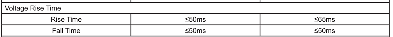

I  purchased TENMA 72-13360 programmable Dc source, actually my requirement is to change Dc voltage from one level to different level. i am trying it in dynamic mode that is available in the option, but i couldn't achieve it, instead of step change in Dc supply i'm getting ramp change, i am unable to give dynamic number and dynamic step to achieve sudden change in the voltage level. how to set slope to get step change, can any one please help me , it is very urgent for my research work
    Jan Cumps over 1 year ago +2 verified
    What edge time do you need for your tests? Power supplies are typically specialised in keeping steady power. Their output capacity makes that they aren't fast voltage jumpers. You may have to use a…

    +1 Jan Cumps over 1 year ago
    You may have to use a function generator with DC option for this research.
    The user manual of the Tenma gives some indication of it's "get to voltage" speed:
    Although that doesn't really shows how big of a voltage change it is. I assume here that's the time it maximum takes to reach the set voltage when enabling the output.

    You may have made a mistake in choosing this power supply. It's cheap but very loosely specified. They give no data on rise and fall time for a change in demand.
    Could you explain what waveforms you are trying to achieve and the purpose of them and maybe some kind of work around will be possible. Remember that the supply is a singe quadrant type (can only source current and not sink it) so the fall times with light loads will be poor.
    Are you using remote control and the VSTEP command ?
