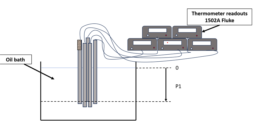

Hi everyone,
I'm encountering a strange behavior during an intercomparison between several calibrated RTD temperature probes. Here's the context:
  • I'm using 5 RTD sensors, one of which is a Hart Scientific 5615.
  • Each sensor is connected to its own readout instrument.
  • Measurements were performed in both an oil bath and a dry air oven to rule out medium-related effects.
  • All sensors were allowed to stabilize for over 20 minutes at each temperature point.
Observed behavior
  • From 0 °C to 121 °C, all sensors agree very closely, with negligible deviations.
  • Below 0 °C, the 5615 starts to deviate by approximately 0.2°C from the others (MPE is at +/- 0.03 °C yes extreme precision is needed).
  • Once the temperature is raised again, the 5615 returns to normal behavior.
  • The issue is repeatable, regardless of medium, measurement point, or configuration.
Hypotheses already ruled out
  • Response time: ruled out (long stabilization time).
  • Material or construction differences: all sensors are identical in build and sheath, the only difference is the model of this particular sensor, but it's calibrated by the same Lab and it shouldn't be a problem.
  • Measurement point: tested at various positions multiple times.
  • Measurement medium: tested in both oil and air, I get the same result.
  • Readout device: each sensor has its own dedicated instrument.
Possible causes under consideration
  • Incorrect application of ITS-90 or Callendar–Van Dusen coefficients in the readout?
  • Localized calibration error at low temperatures, is it possible? Could it be that the sensor is linear for "high" tempreratures and non-linear for "lower" ones?
  • Firmware or electronic behavior specific to the readout used with the 5615?
  • Interpolation or coefficient misapplication in the readout or calibration file?
Has anyone experienced a similar issue with the 5615 or other high-precision RTDs?
Any suggestions for further testing or troubleshooting would be greatly appreciated.
Thanks in advance!

     metroman I'm no expert, but the problem is intriguing.  Is the Hart the "odd man out" or do you have 5 unique instruments?  Have you moved the sensors between instruments to isolate it to the 5615?  With the sensors being as precises as they are, maybe it's the difference of a picogram of solder somewhere in the circuit.  Are there any probe adapters or anything like that in your sensor circuit that makes that instrument different?

    It's not quite clear to me what your set up looks like - does each sensor have its own read out device or are you using 1 read out device with 5 different sensors.
    If the 5615 sensor is always used with the same read out device ( by which I mean the same single physical device, not just the same make and model)  then you can not tell if the errors comes from the read out device or the sensor.
    How does the calibration work - is it electronic or paper - what does the calibration of the 5615 look like compared with the other sensors.
    What does the error profile look like "Below 0 °C, the 5615 starts to deviate by approximately 0.2°C" isn't specific enough - a graph would help.
    Is 20 minutes long enough (a graph of reading against time would tell).
    What are the differences between the sensors (dimensions, cable, connectors etc.)
    What do Fluke have to say about it ?
    MK

    Each sensor in my setup is paired with its own dedicated readout device, and they are calibrated together as a system. Because of this, I can’t swap instruments. The sensor that shows the deviation is a different model from the others, although all of them are Hart Scientific RTDs and those particular sensors were calibrated by the same lab on the same range of temperature -50 to 150 °Cimage.
    The deviation of about 0.2 °C below 0 °C is clearly beyond what would be expected for this class of sensor. To be more precize for instance when I go to -20 °C the 4 other sensors show values around -19.923°C and the 5615 sensor shows a value around -19.710°C. This is very strange because it behaves like that only for those low temperatures and behaves correctly for the rest. I will try and simulate a stabilization curve to be sure (thanks for the idea), however 20 minutes should be more than enough for thermal equilibrium in this setup (according to specifications and my past measurements done with this sensors.)
    All sensors use the same cables, connectors, and immersion depth P1, so there are no physical differences that could explain the issue. In the image above you can find my attempt to schematize my setup.  I haven’t contacted Fluke yet, but that’s the next step I plan to take.
    Thanks again for your insights they’ve really helped me clarify my approach and think more.
