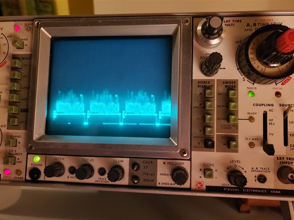

    I was expecting that with out a cartridge you would have a composite signal on the video out put cable including vertical and horizontal sync which would produce a blank page on the tv then  Kiltro could check for the same, this could be measured with a 5mhz scope (anilog or digital) and elimites stuff,

    Just measured this now.  When there is no cartridge there is no synch signals.  In fact there is no signal at all.  The image below is what you see when the cartridge and jumper pack are installed.image

    I see, I will check again on my oscope but I think I dont have those. For reference, can you give me your scope settings for this wave?

    0 dang74 5 months ago in reply to kiltro
    My scope was set to 20us/DIV and 0.5V/DIV.  I may have engaged the variable horizontal knob... so it might not be exactly 20us/DIV but something close to it.  Because it's an old analog scope I can't advise you on trigger level.
