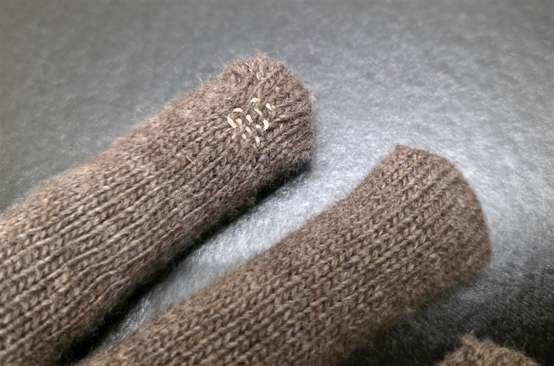

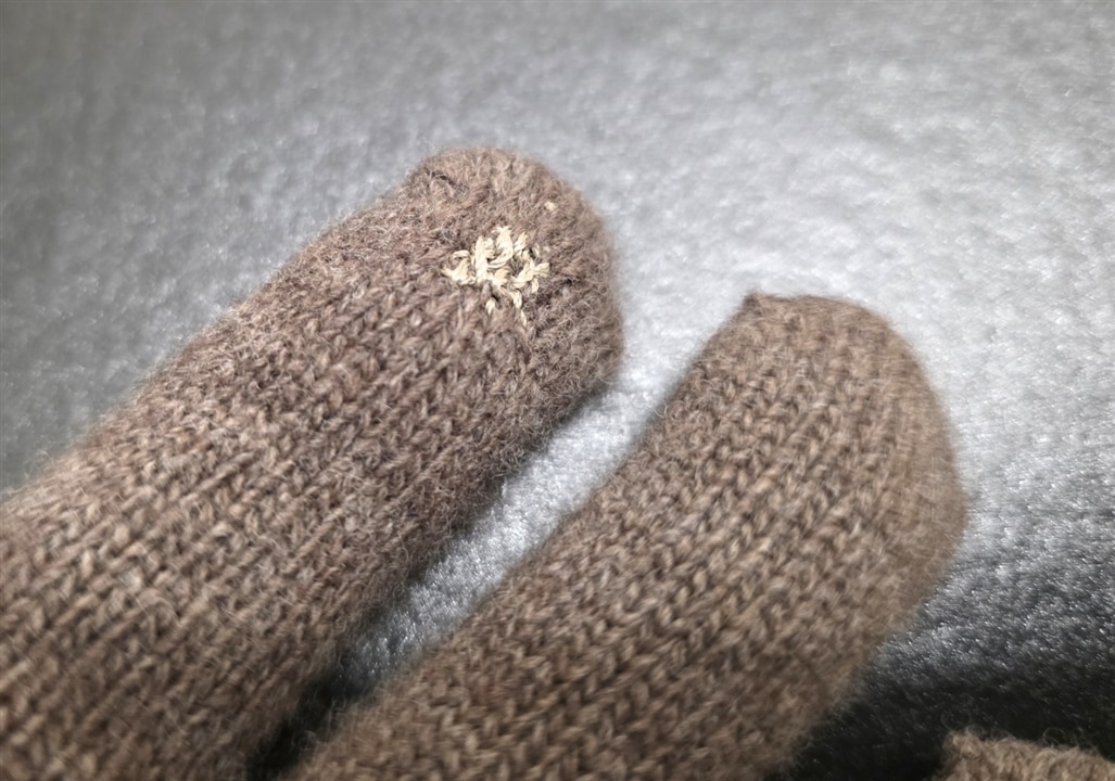

    Case in point: I experimented with making my gloves touch-capable over winter. No point if the project stretched beyond winter, so my project deadline was clear. I knew I had to order quickly and try to experiment fast. My first prototype didn't work. The second one did, to an extent, it was usable although not great. Still, I met the self-imposed timeline. If I'd shot for 'killer' and 'next-level' it would probably be next winter by the time I'd have completed, and sometimes having something to use or demo fast that you can iterate later, is better than having nothing to demonstrate for a year.
