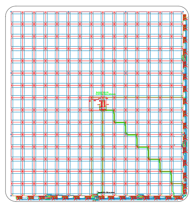

Hi,
I want to make a custom dimension - 20mm x 320 mm - external antenna coil for PN5180 NFC Module/Chip.
To do this I need to design an antenna that has inductance of 0.8-3 microhenry, and then a matching circuit to match with the chip/s 20 ohm load impedance at 13.56 MHz.
I only have an oscilloscope and a signal generator.
My questions are,
1. How do I measure inductance of the following antennas
2. How do I measure impedance on the pn5180 module, and when I do, the result should be 20 ohm, right?
3. Can I measure inductance of the antenna on the pcb? I should disconnect the matching circucit to do it, right?
4. How do I disconnect the pcb antenna from the module and connect to it either of two coils from photos above.

    As Shabaz and BigG have said, a VNA is ideal for not just measuring your antenna, but calculating and checking the component values for the matching circuit. NXP provide good documentation on this, but you won't be able to get far without at least knowing the antenna inductance.

    Hi Shabaz, I read your articles about Low-cost VNA unboxing, and guide to getting started with VNA. Thanks for writing them! May ask, how is that Low-cost NanoVNA working now in practice? Would you still recommend buying it? and if I may ask, from which platform, which supplier/bradn did you got yours and at what price, becauase when I search on Taobao, Temu, aliExpress there are so many of NanoVNAs of the same brand and still have different prices (different enough to matter - like $50 differences). I want to create 15x15 grid nfc antenna, 15x300mm to make a scrabble game board. instead of making 225 antennas, I will make 15 column and 15 row antenna, and multiplex them to get a exact location of the tile/piece. I am afraid to get a NanoVNA that will not be able to help me there, or do you think it will?

    A VNA is like a flagship instrument for measuring inductances (and more) at RF frequencies, so it's definitely a suitable tool for inductance measurement, but with that caveat that I don't know how far you are prepared to go on that learning curve. Traditionally, only niche industries and RF engineers were prepared to invest that time.
    The NanoVNA H4 is a very general-purpose, all-round useful VNA, so if you do want a VNA, you could do a lot worse than buy that. I got mine from "Zeenko Store" on AliExpress (I believe that is the official seller).
    The next question is, will inductance measurement be sufficient to achieve your actual objective, which is to have (I believe) a very long NFC antenna coil that works well along the entire length? The VNA won't measure any electromagnetic fields (well, it might be able to do so but in a more spectrum analyzer-like mode if it can do that, and with different probes). And even if that was successful, the results wouldn't specifically show you what change needs to be made to improve performance, so you could be there tweaking things for days or weeks on end (I'm guessing, no idea, since I've never tried this).
    In reality, if you really wish to make such an unusual shape antenna work without a lot of trial-and-error, then you'd want to design and simulate it. There is free AN-SOF software, it's got a learning curve too (but hopefully not too much) - I've only used it for a very simple antenna, I've never tried it for NFC. Another option is HFSS, and there is a student license or a trial license, but I don't know the terms/conditions. You could also consider Matlab (see here: https://uk.mathworks.com/matlabcentral/answers/2180231-matlab-nfc-antenna-simulation  ) since the "home user" license is affordable (ballpark $100 but I've not checked recently; you'll also need to purchase add-ons called toolboxes, specifically at least the Antenna Toolbox, but more may be needed at a later point as you proceed).As mentioned, all these software options have learning curves.
