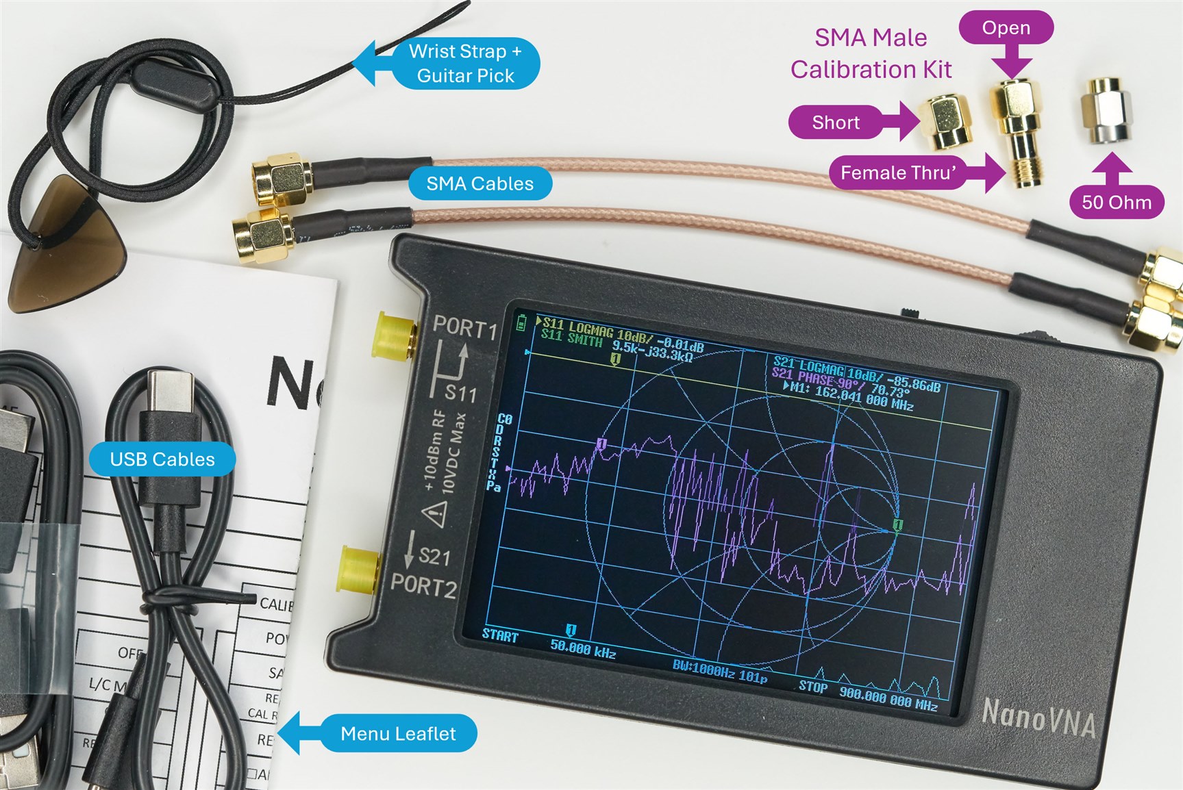

It comes in a sturdy box. The packaging internally is almost as nice as high-end smartphone packaging.
There’s lots in the box. There are a couple of USB cables and an instruction sheet containing the details of the menu system (there are a lot of menu pages!), and a wrist-strap with a guitar pick that is extremely useful for tapping on the screen to configure the instrument. As well as a couple of low-cost SMA cables, there is also an SMA Male calibration kit. To be honest, most of the accessories are not worthwhile, apart from the wrist-strap. The SMA calibration kit is OK, but you’ll want to upgrade that at some point. Same with the SMA cables.
The USB cables are junk; I could not plug them in, they felt incorrectly tight. It’s best to throw them away and use your own USB-C cable.

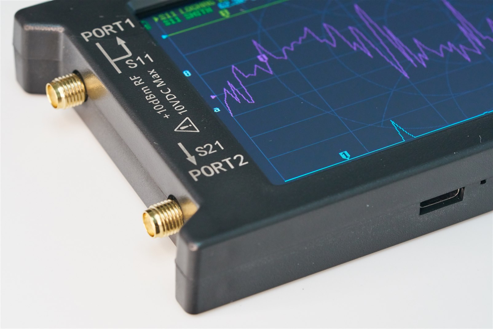

The photo here shows the two SMA connectors (it’s a two-port VNA), and the USB-C socket at the bottom.
The top edge contains the wrist-strap hole, and a left/right jog-wheel which is pushed inward to enter the menu and to click on items, and a slide-switch for power (there is an internal rechargeable battery).

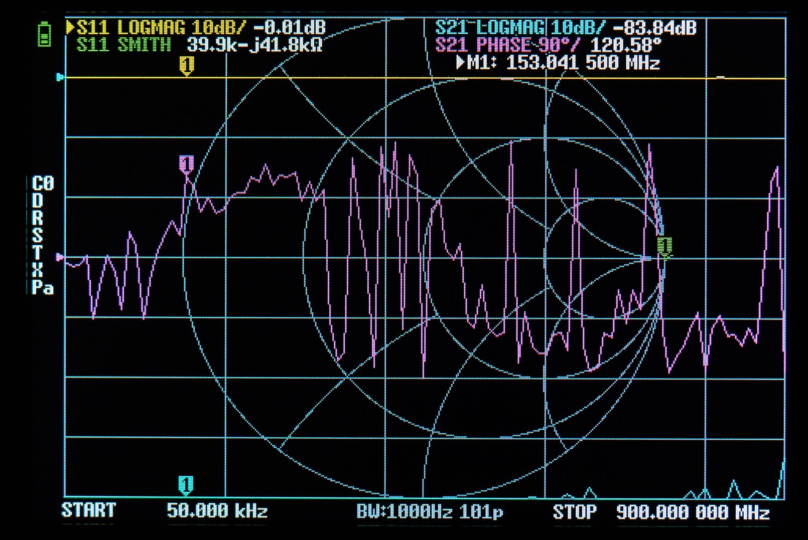

As mentioned, the display is surprisingly good. Not top quality, but better than expected for the price. It’s also of a decent size. I had expected to need to use a PC application to drive the instrument, but the NanoVNA-H4 is actually fairly usable directly from the built-in display, even without teenager-grade eyesight.
This default display is a little busy; not a fan of the multiple overlaid charts! I intend on switching off everything and defaulting to just a Smith Chart display if I can.
I had been dreading that the user menu (menu structure PDF downloadable below) would be very awkward to control with the jog-wheel method, but it’s not bad at all. Plus, bonus, the guitar-pick on the display makes everything very quick to select if you don’t wish to use the jog-wheel.

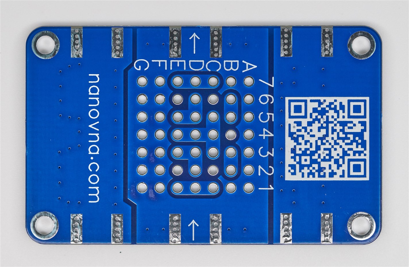

As optional extras, I purchased two better-quality cables (about £7 each from the same store) because a VNA requires that. Also, I purchased a ‘test kit’ which consists of a PCB, some mounting hardware, two 50-ohm surface-mount resistors, four SMA connectors and two strips of pin sockets. I think the aim of this test kit is to be able to solder in a load of the pin sockets, and then you can push in components like capacitors, inductors etc.
The top side of the test board is hard to follow, but that’s not a big deal because it will be covered with pin headers anyway.
Fortunately it’s clear to consult the layout from the underside.
