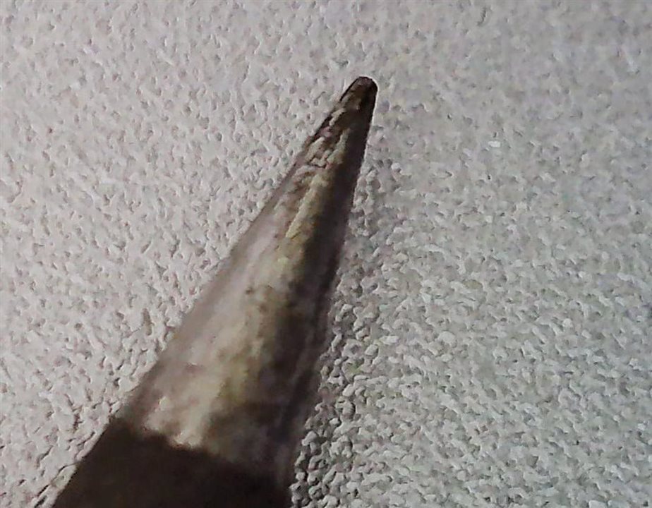

Hi I have an ERSA I-CON PICO solder station that has served me really well for several years when suddenly the 'pencil' tip has become un-tinnable.
It is the :-
://uk.farnell.com/ersa/0102pdlf04-sb/tip-soldering-iron-pencil-0-4mm/dp/1203967
A 0.4mm pencil tip which is great for getting into solder the tiny legs of SMD IC's.
I had used ERSA Digital 2000A's for years and years and then bought two of the I-Con Pico's (one for me and one for my son) a few years ago as we are both into SMD development and assembly.
I have never had a problem with the tip of the iron until recently when I just couldn't get the very tip of the bit to accept solder.
The solder station is not used on a daily basis (hobby use only) and is only switched on when required, I always use the supplied brass (Brillo pad) tip cleaner and this has kept the tip clean and operational until now.
Inspecting the tip I can see that it is still sharp with no visible pitting or corrosion, however it has a grey appearance instead of a 'silver' tinned area right at the tip.
I imagine that these tips have a special coating and shouldn't have anything abrasive applied (sandpaper/file etc) so I am wondering if the tip can be easily restored, or has it reached the end of it's life??
Any suggestions would be gratefully received, as both solder stations are suffering the same problem.
Thanks ...Daveimage

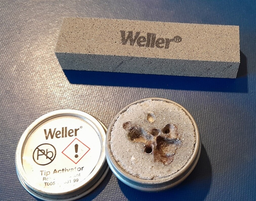

    I think that you have to treat the tip as having reached the end of its life. I have used tip cleaner (sort of waxy stuff in a little pot) but the effect doesn't last long). MK

    I have used these products to revive tip wetting issues: They aren't general maintenance solutions. Intended to recover what otherwise would be a throwaway.

    It looks like the tip got too hot.
    Or perhaps some foreign material was soldered onto it.
    This can also happen unintentionally if you accidentally touch something while soldering.
    If I want to burn off the scale, I use solder wire (>1mm, preferably lead-tin) with plenty of flux.
    For cleaning, I use a sponge soaked in water, not copper wool.
    Apply solder several times, wiping in between, until a layer of solder remains on the tip.
    The correct melting point should be observed.

    0 davebullockmbe 5 months ago in reply to geralds
    Hi Geralds,
    Yes I wondered if the tip had got too hot.
    So what I've tried:-
    I just very carefully scraped the tip with a scalpel blade being very gentle so as not to cause the blade to 'dig' in or remove metal.
    The dark grey material does seem to come off and the tip returns to looking like the 'wider section' that solder DOES stick to.
    However the tip still refused to tin at first.
    As you said though continuous wiping and feeding copious solder onto the bit with it pointing down (making a large droplet of molten solder that envelopes the tip)
    does seem to improve things and I managed to get part of the tip to tin again.
    From what you have said, I guess I should press on cleaning and soldering over and over an see if the situation is resolved?
    Like you I have been using solder stations since the 70's but of course these were crude 'curie' controlled ones like Weller's.
    We are now a long way from the old ANTEX and even SOLON irons from the early 60's when I started soldering..lol!
    Thanks everyone for your thoughts/hints/tips, please keep them coming
    Dave

    The business end of a soldering tip is plated with iron to protect the copper and allow solder wetting. When solder is scraped off the iron (by brass wool) it can expose small areas that start to oxidize. Solder does not stick to rust. To revive the tip, it is necessary to remove the rust and immediately tin the tip with solder. Rust can be uneven, forming micro-pits which are hard to see and hard to remove. The iron layer is also pretty thin, so aggressive rust removal can remove the iron, which is needed. Tips can usually be revived enough to be used for non-critical soldering, but at some point it is not worth the fight.
    The reason I don't use brass wool is that it seems like it might be able to scrape the solder down to bare iron. (I do not have any proof)
