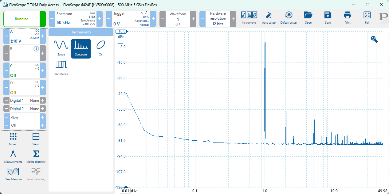

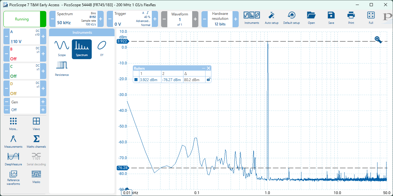

    I measure the distortion at 5V RMS from a Neutrik Audio analyser (its THD is < 0.004% or -88dB), neither scope can get near the right answer but the 5444B is much closer.  Im thinking of buying the new 5462e but it's spec for distortion a SFDR (Spurious Free Dynamic Range) is on 3dB better than the 5444B (73dB rather than 70dB) so I'm not sure if its worth it.
    5444B measuring 1kHz sine from Neutrik A1, 12 bit setting for more direct comparison with 6242e (below).
    6242e measuring the same signal.

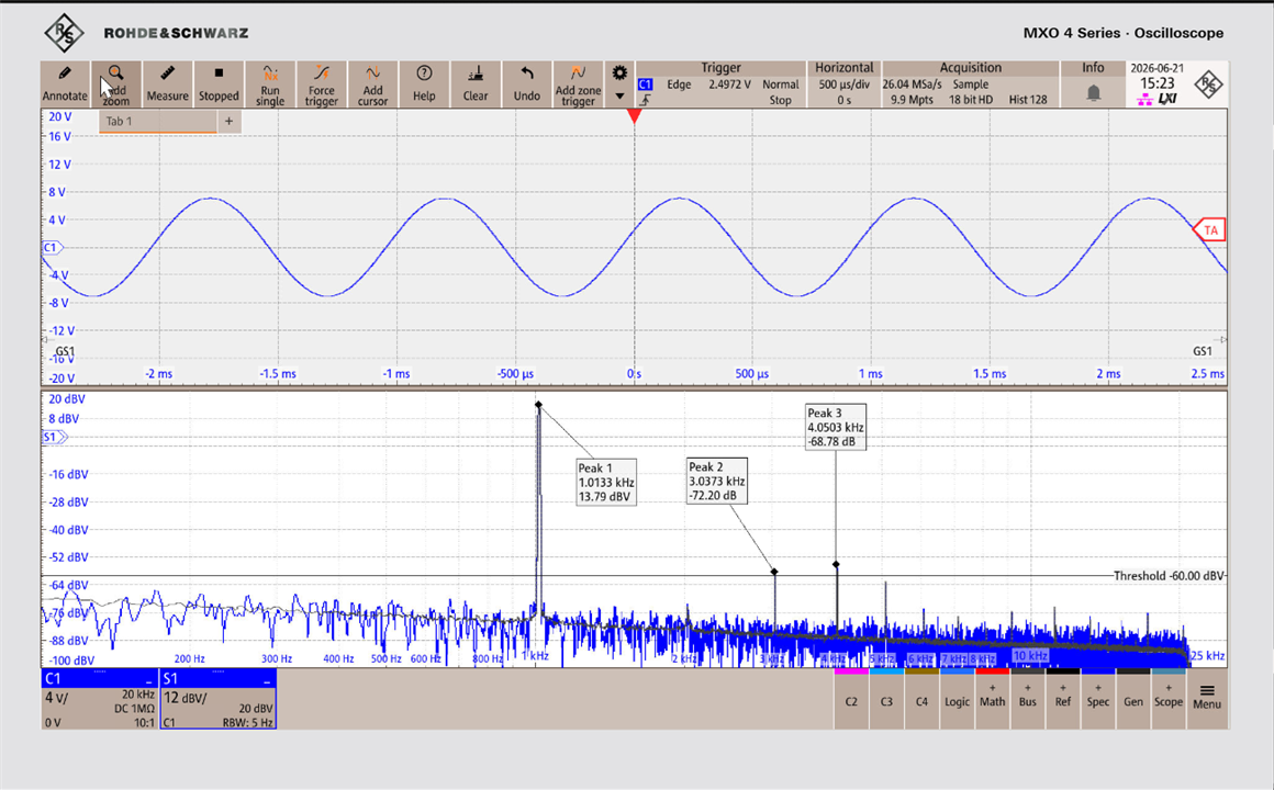

    The R&S MZO4 does a lot better than the 6242e (so it should at 3x the price) but not as well as the 5444B - you can buy a reasonable car for the price difference there !

    Hi Michael,
    Interesting traces! Normally the noise floor is far lower on the MXO4, but I guess it might be some sort of issue due to the amplitude of the 1kHz tone? If so, I'm wondering if a very narrow notch filter could be made (maybe an LC one but I've not done any exploration to know if it's feasible.. would be very high value inductors and might drift too). Admittedly it's a crude workaround even if it works though : ( in the RF space, it's easy, since then a crystal filter can be used, it was a popular technique there.

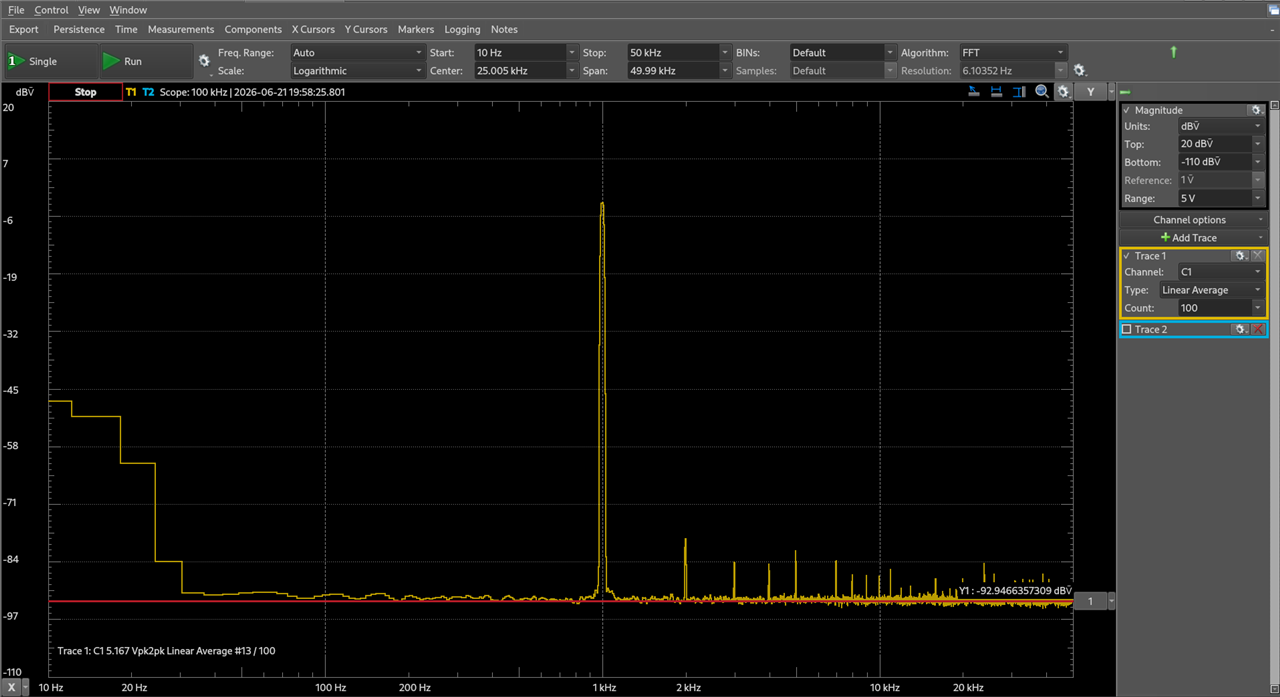

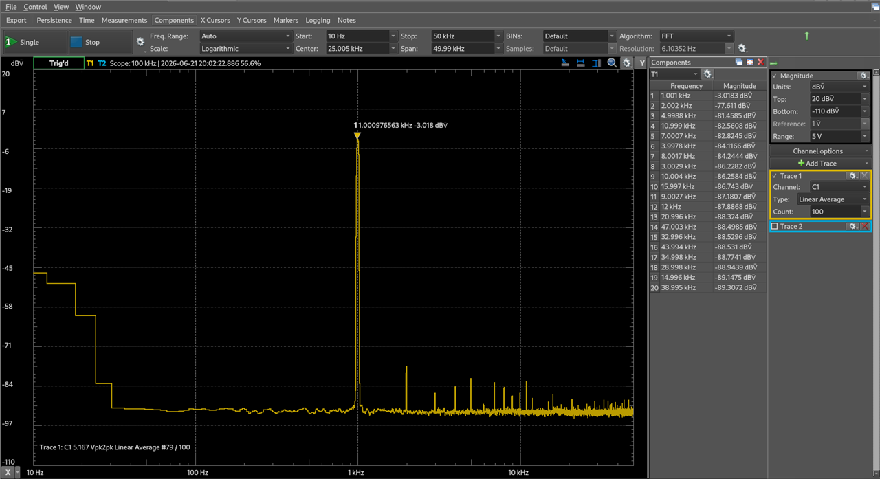

    I think it is worth taking a look at something from Digilent. I personally use AD3 for basic things. WaveForms is really great software that has ready-to-use components, e.g., Waveform Generator, Impedance Analyzer, Spectrum, or Supplies that could be modulated by the generator to simulate noise. There is also support for SDK. Here is an example of using the SDK to integrate the usage of some devices with ngscopeclient. Of course, the hardware is a bit limited if you're looking for something with a low-noise front end, but the series ADP3X50 or new ADP2440/2450 could be quite good. In that area I think that PicoScope gives more flexibility and better parameters. You can find hardware that has a fast sampling rate with large memory, like the Series 3000e or the latest 5000e series, where you can get a hybrid solution, native 16-bit, plus the same features from the 3000e.
    Here is similar as Michael measurement (1kHz sine 1V amplitude from AD3 generator) done with AD3:

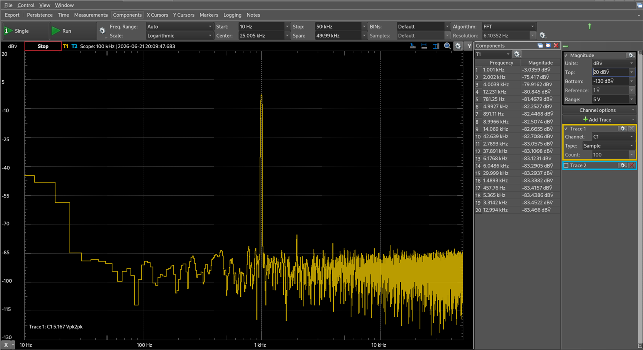

    And as a curiosity, output from Siglent SDS824X HD:

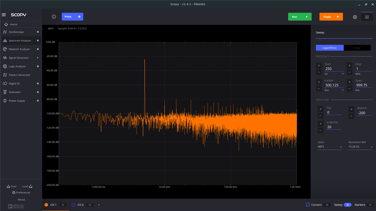

    0 kk99 4 months ago in reply to BigG
    It's worth mentioning that Scopy is fully open source.
