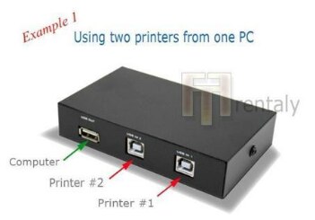

I have a need for what appears to be a rare device. I have software that prints to a default USB printer. I cannot change the software. The problem is I have two USB printers. I want an A/B switch box that I can use to select which printer is plugged in.
This would be the equivalent of just unplugging one printer and plugging the other in. This is for an industrial installation with 100's of devices required. The end user isn't able to change software and doesn't want associates swapping USB cables all day long.
All the USB selectors that I can find just share USB devices between two computers.
This is the only one that I have been able to find, but am weary about offering it: https://www.newegg.com/p/36F-00D5-00007?item=9SIAK1JB676151&source=region&nm_mc=knc-googlemkp-pc&cm_mmc=knc-googlemkp-pc…
I was really hoping to find a name brand like IOGear or similar, but keep coming up empty. I just need a single upstream device (the computer) and two downstream devices (Printer A, Printer B).
This image is from the NewEgg listing.
In theory, even the normal USB selectors 'might' just work by default if they are just A/B switch the D+ and D- on the USB bus between the two ports without other active components involved.. but the problem is I don't want to have to get a bunch of different samples to test with. I want to buy something off the shelf that I know works.
Has anyone seen something like this before?

    The problem you will run into, is that one USB1,2 Hub can service 127 devices, and there is handshaking between the devices and the computer (when it's first plugged in) to determine device type, identification for drivers and speed negotiations.  If you change the printer, it's configuration is now invalid and the new printer will not know what the configuration was/is.  USB is not like RS232, you can't just swap the data lines between devices and assume it will work.

    I have proposed the Standard switch + reversed USB cables and will see what they will accept. Thanks for the suggestions!

    Since it's low-cost, I think it likely just contains a multipole switch, and it is switching over (at least) the two data lines and the 5V connection, if not the ground connection too.
    It is probably fine for USB full speed perhaps, which I'm guessing is fine for printers.
    As Dave says, if such cables are available, then it's likely to work (but definitely test on one before ordering a hundred : )

    Or perhaps just use type A-to-type-A and type-B-to-type-B cables ?

    I need one with the opposite physical ports than that one.

    2-Port USB Data Switch - SB-422
    https://cpc.farnell.com/pro-signal/sb-422/switch-manual-2-1-usb-1-1/dp/CS13282?st=usb switch
