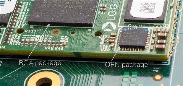

Some people (not me) can successfully solder incredibly tiny Quad Flad No-lead (QFN) parts such as the one in the photo below by hand using a soldering iron or a hot air gun (the photo below is from a commercial board, not hand soldered). For wireless devices and modern sensors, surface mount device (SMD) packages as small as QFN have become the normal, default package.

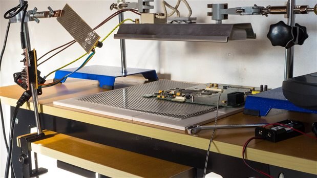

Trying out some Heating Elements
To speed up development, the strategy was to start constructing a potential enclosure while narrowing down heating element possibilities at the same time. A couple of heating elements will be tested. If they are unsuitable, then more will be tried. The controller for the reflow oven will be based on an off-the-shelf microcontroller development board. For the initial experiments, no electronic oven control capability will be used; the heating element will be switched on/off using a mains switch. The initial tests will be in free air. The test results won’t be usable since the elements are not in an enclosure, but the aim here is to just get some experience with the heating elements and begin to see their characteristics.

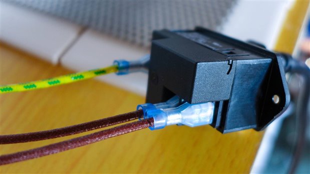

The photo above shows the setup so far. The heating element is suspended 100mm above a scrap circuit board. For now, the element is connected to the mains through an IEC connector with built-in fuse and switch, as shown in the photo below. It may need to be replaced with a hot IEC socket for the actual build.

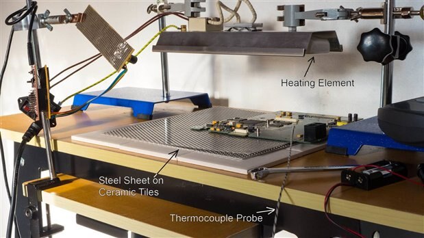

Here is an annotated photo of the setup:

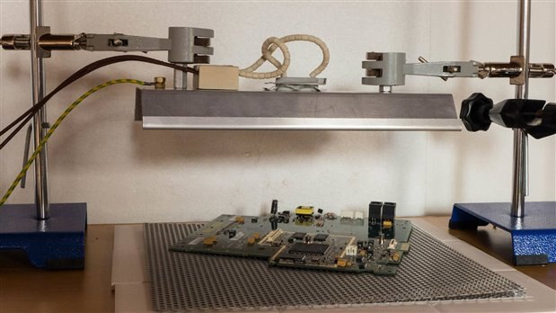

Another view without all the cables:
