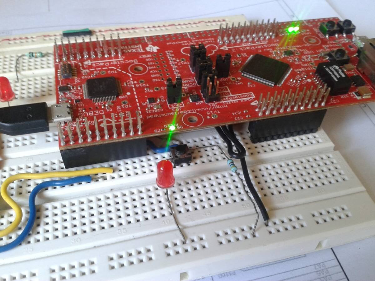

For testing the idea I came up with a simple test circuit as shown in figure :
I have added two pots to analog pins A0 and A1 each and a LED to ground via switch at A3. Also at D0, an LED is added to ground via a 4K7. So when I change the pots, a sinusoidal waveform will be caught on screen. And when I press the switch, A3 will be pulled down via an LED, plotting a square wave. When you press 'D0' button in webpage, it will trigger LED2 in the circuit. Here is a few snaps of my test setup
