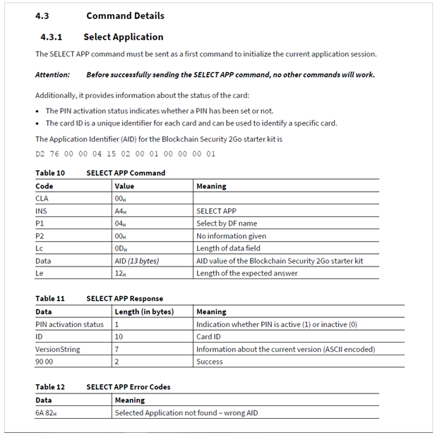

APDU Command Code
All the values from line 2 to line 7 are exactly the same APDU command bytes as in Infineon's application developer instructions.
I've pasted the relevant part in the table below the code.

Here's than analysis of line 6, the APDU command.
Because I'm running the first, mandatory command to start the app session, I can just reuse my analysis of the Android example app for the card:
Command analysis from my first post:
Send the SELECT APP command
This is the first command you have to send to the card before it can be used in a scenario.
The APDU command: 00A404000DD276000004150200010000000100.
image source: User Manual Blockchain Security 2Go Starter Kit
APDU Send / Receive Communication Script
  • 00 this is the instruction's class
  • A4 this is instruction A4: SELECT APP (open application session)
  • 0400 parameters 1 and 2 (both a byte). 04 indicates that the app is determined by the DF name. Second parameter is not used in this function.
  • 0D the AID data field hereafter has a length of 13, (0x0D)
  • D2760000041502000100000001 the AID of the Infineon cards.
  • 00 length of the reply. The value Infineon's guide suggests here surprises me...
APDU Answer from the Card:
After sending the above APDU command the card, here's the reply received in the buffer data_in.
And my analysis of the Android phone app response is again valid, because I tapped the same smart card:
Response analysis from my first post:
Analyse the Reply
This is what what the card sends back: 0002090C2900020040001576312E309000.
  • 00 the pin isn't set for this card
  • 02 09 0C 29 00 02 00 40 00 15  the ID of this particular card
  • 76 31 2E 30 the ascii version string.  v1.0.
  • 90 00 the return code. Success
