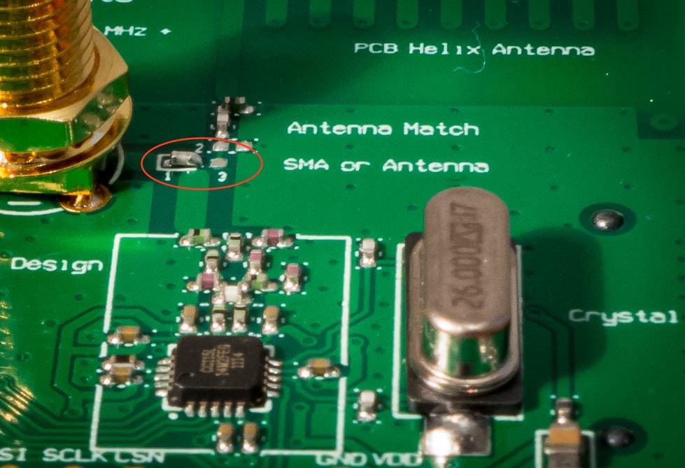

Replacing the Antenna
The radio evaluation modules that are supplied as part of the development kit have an on-board PCB trace antenna with exceptional performance in real-world experiments; I was able to maintain a reliable packet transmission from my home to the next street.
I decided to move the small 100pF capacitor from position 2-3 and move it to position 1-2 (see the circled area in the photo below) in order to disable the on-board PCB antenna, and direct the transmission into an RF connector. This would allow me to be able to connect up a spectrum analyzer and view the transmitted signal.

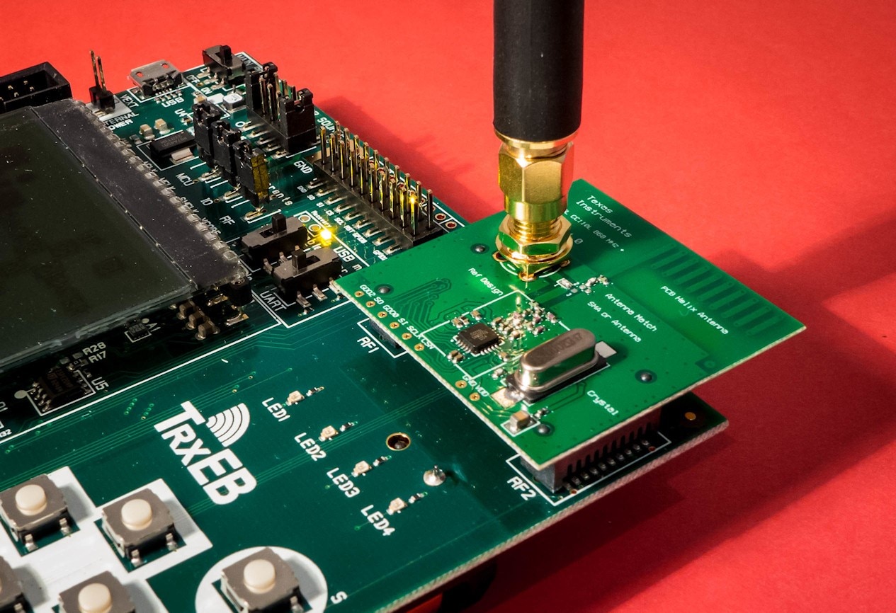

It also provides the opportunity to be able to test other antennas too, as shown in this photo:

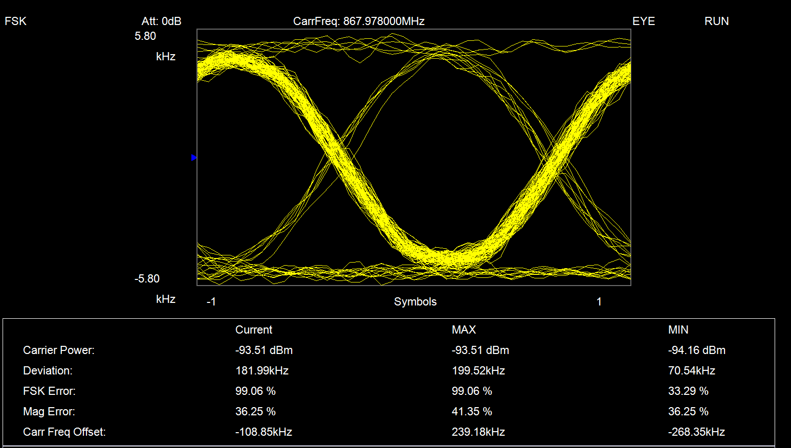

Observing the Output

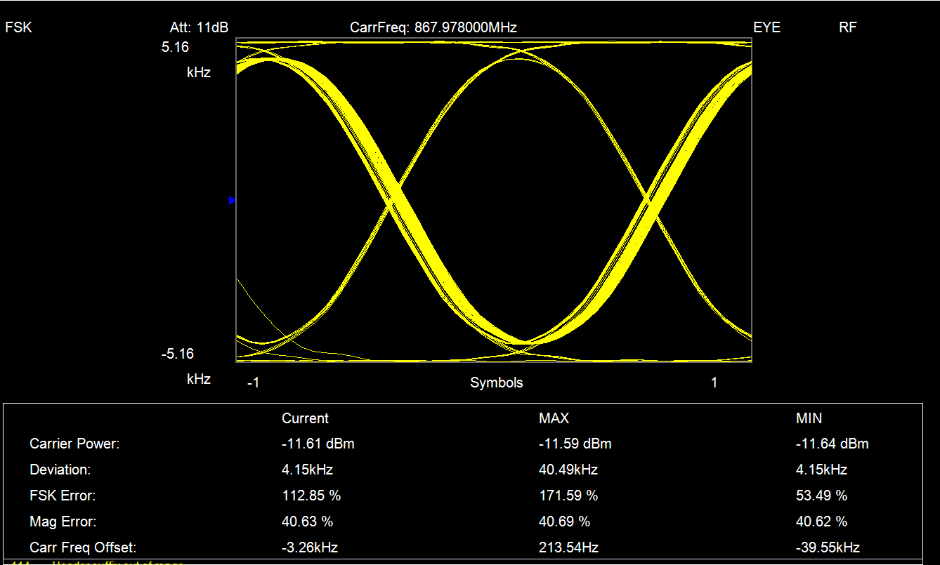

It proved possible to generate an eye diagram, nicely showing the frequency deviation and the clean output. As you may expect from the clean image, this is from a very high output (-10dBm).
It is more interesting to progressively drop the input to a more realistic signal:
To perform the attenuation, see here for information. If you’re wondering why the eye diagram is eye-shaped across a radio transmission, it is because the TI CC11xL chips perform frequency transitions in-between the FSK frequencies. This is an option on the TI chips. If it is disabled, this is the result:
It’s also interesting to see the comparison in the spectrum view as shown below. Here you can see the raw FSK signal in blue, and the smoothed transition (also known as Gaussian FSK or GFSK) in yellow. GFSK clearly has far less spread than the usual frequency-shift keying.
