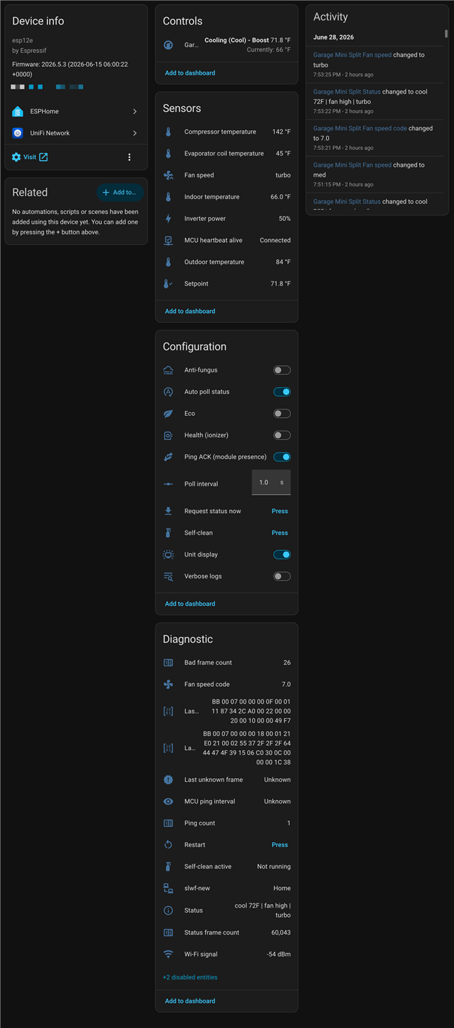

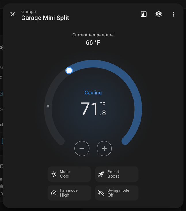

  • agranted
    agranted 3 months ago
    Another year passed, a cross country move (including moving my Della), and a reinstall of the minisplit I was able to revisit this. I'm happy to say I've got a stable ESPHome build running on the SWLF-01 with a Della 048-MS (https://github.com/adamgranted/esphome-della-ac)
    The 048 utilizes the AUX OEM protocol with what appears to be minor frame variations between models. At this point the firmware is 100% fully featured for the 048 and will soon have support for the Della Motto 12K1VRH-20S-JA-I+O.
    Some HA screenshots:
