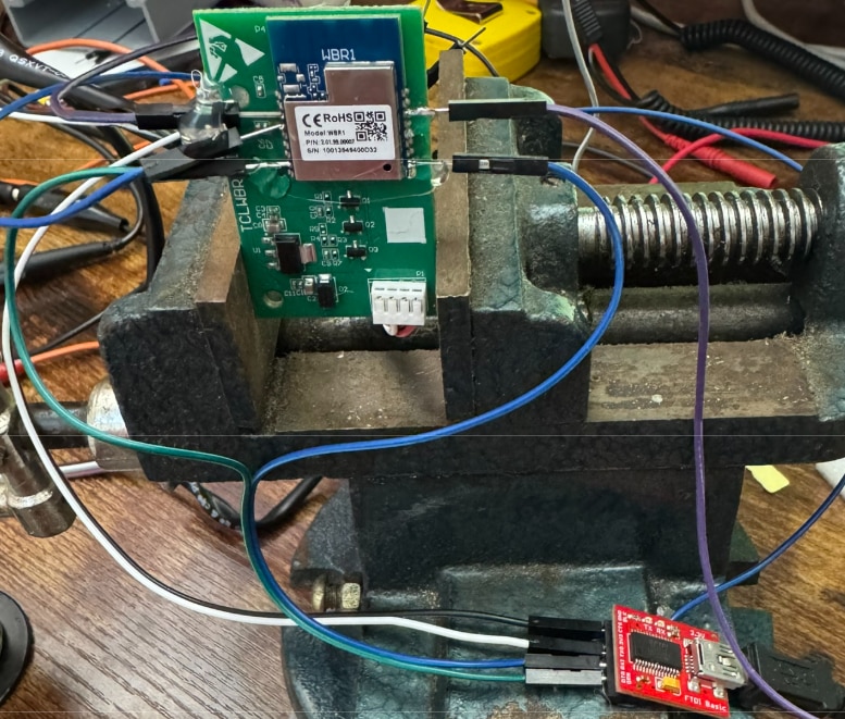

    Hello,
    I spent a few hours on this today. I left the WBR1 mounted on the carrier board and fed it with 5V. (the board converts down to 3.3v). I can see the current start at about 60ma then drops to about 20 after boot up.
    I am having trouble running the BK7231 Easy Uart Flasher. It won't launch when I double click it. I run Compatibility Checker in Windows and that can get it to launch. But I can get past that part.
    Now for communicating with the module - I have a 3.3v RS232 unit hooked to LogRX and LogTX. RX and A0 I tie to 3.3v while tapping EN to ground. I can see the current drop to 10ma.
    But the Uart Flasher never seems to do anything. and I get error messages as shown below.
    So this is the part I'm stuck at.
    Here is my setup - module held in a vice and using hot glue to secure everything. image

  • Thehofl
    Thehofl 11 months ago in reply to aspork42
    Hey there. I could not get a successful flash until I de-soldered the WBR1 from the secondary PCB. You might try that.
    Also, I took backups with AmebaZ2 or ltchiptool. I don't quite recall. Since the chip is Realtek, I used the  "AmebaZ2 PG Tool" to write to it. github.com/.../Realtek
