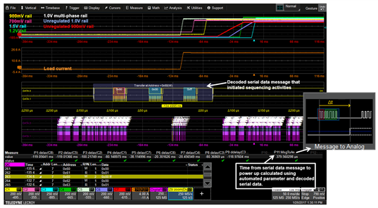

For any system to start up correctly, the DC power rails must turn on in a specific order, with a predetermined latency between each rail's power up. Conversely, sequence testing is also critical in the power-down process. Figure 4 depicts an example of how a serial-data message instructing the PMIC to turn on or off the DC rails is captured and decoded on an oscilloscope. The delay in each power rail's ramp up (or down) can be measured against when the message was sent.
Figure 4: Voltage/power-rail sequence testing is a critical aspect of IoT device evaluation
