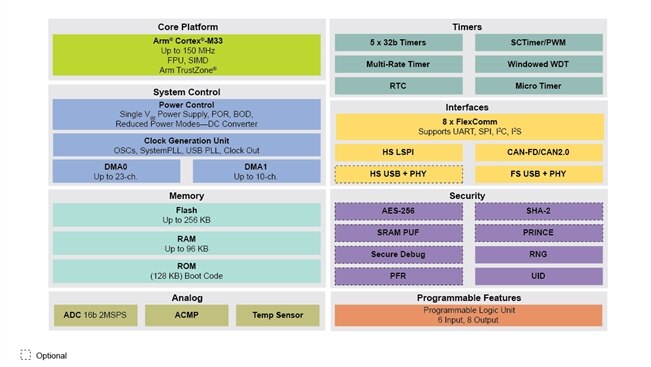

The LPC551x/S1x MCU family expands LPC5500 into a new price point, offering significant advantages for developers, including pin-, software- and peripheral-compatibility for ease of use and to help accelerate time to market, while still leveraging the cost-effective 40-nm NVM process technology.
The LPC551x/S1x is the entry-level family within the LPC5500 MCU series, providing new levels of cost and performance efficiency in addition to security and system integration for industrial, IoT and general embedded applications.
Key Strength and differenciators
  • Ultra-efficient 40-nm flash technology
    • Over 600 CoreMarks and as low as 32uA/MHz
  • System Integration for Industrial and IoT Markets
    • High-Precision ADCs
    • CAN-FD for industrial control
    • HS USB with On-Chip PH
  • Enhanced safety and security with Arm TrustZone-M technology
  • Comprehensive enablement with MCUXpresso Ecosystem
