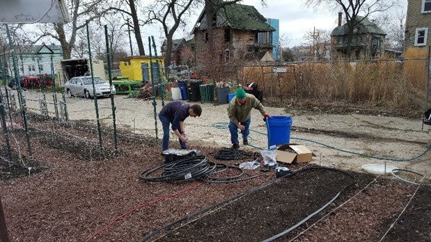

  • April 2016 - Planning: The reason we started small was so that we could test various drip fittings and understand the pros and cons of different types of fittings. Going through this exercise also allowed us to get some hands on experience of working on a real farm and laying down the drip network!
  • May 2016 - Farm setup: Once we locked down the parts, it was time to get half of the farm set up. We had to ensure that the sections are of similar size. Measure twice, and cut once was put in effect,  and the results were well worth the effort.
  • June 2016 - Field Test 2: With the hardware section complete in early summer of 2016, it was time to bring out the star attraction – the controller! We tested out the first version of the controller in the field with the partial drip network (0.25 acre) in place. While there were some issues with the pump sizing, the overall result was a huge success when the control system worked as expected. We had underestimated the total pressure loss in the system, and had to get a slightly larger pump to ensure that the farthest end of the farm also received adequate water. A visit to the local hardware store fixed that.
